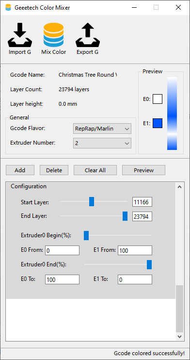

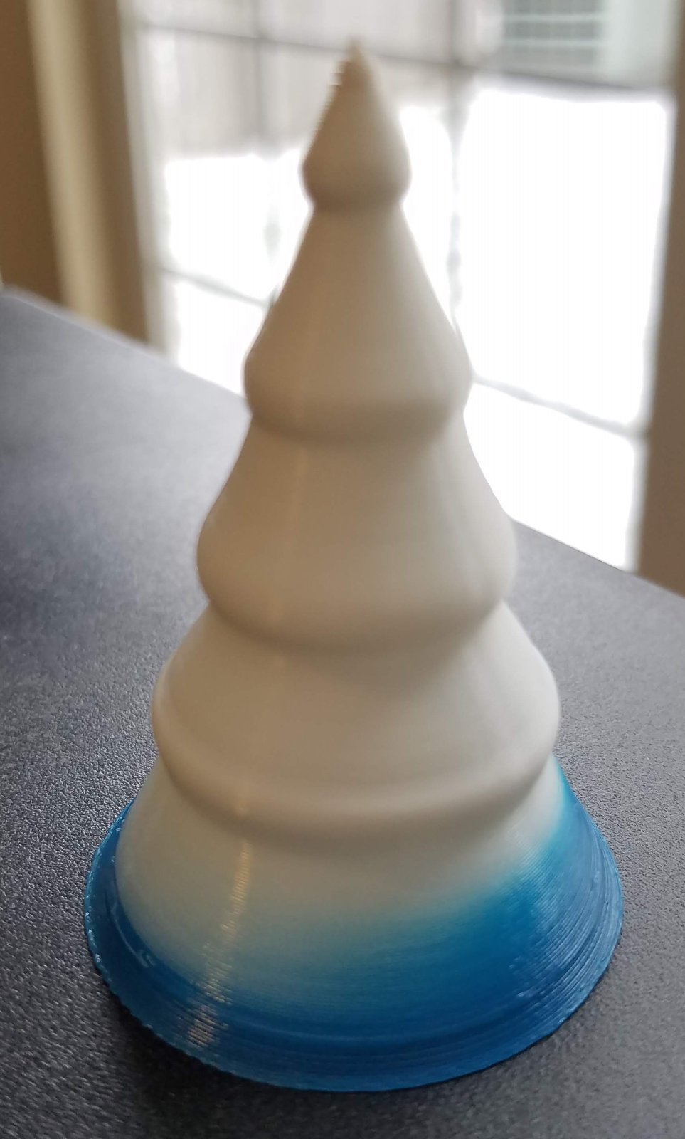

Thanks, William. You'll note that that is the exact link I included in my original post. The little app is relatively intuitive, so the use of it is not an issue. I was finally able to download the 1.1 version and the little gradient preview is helpful. Unfortunately, it still didn't print out what I requested of it. I've included the preview gradient in Color Mixer and a photo of the printed object (again, in vase mode).
Color Mixer Tree Color.png (23.27 KiB) Viewed 15109 times
You might notice a strange pattern in the gradient (color mix) as well. One one side of the model, the blue goes higher than on the other, as if the color was actually fluctuating back and forth (many, many times more than I asked for) between blue and white as the printer spiraled its way up from the bottom, until it eventually gave up on the blue entirely.
What I would expect is a slow transition from blue to white to blue to white again (per what I put into the Color Mixer and what you see in the gradient screen shot).
Is this a known issue? Is there an official place to report bugs?
