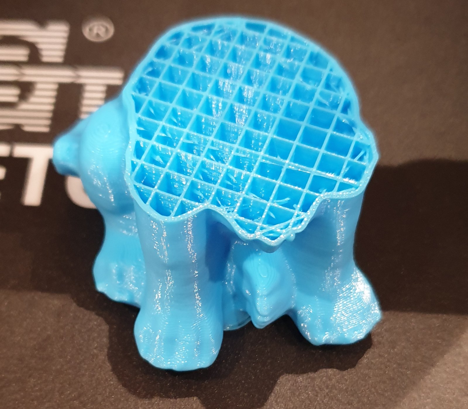

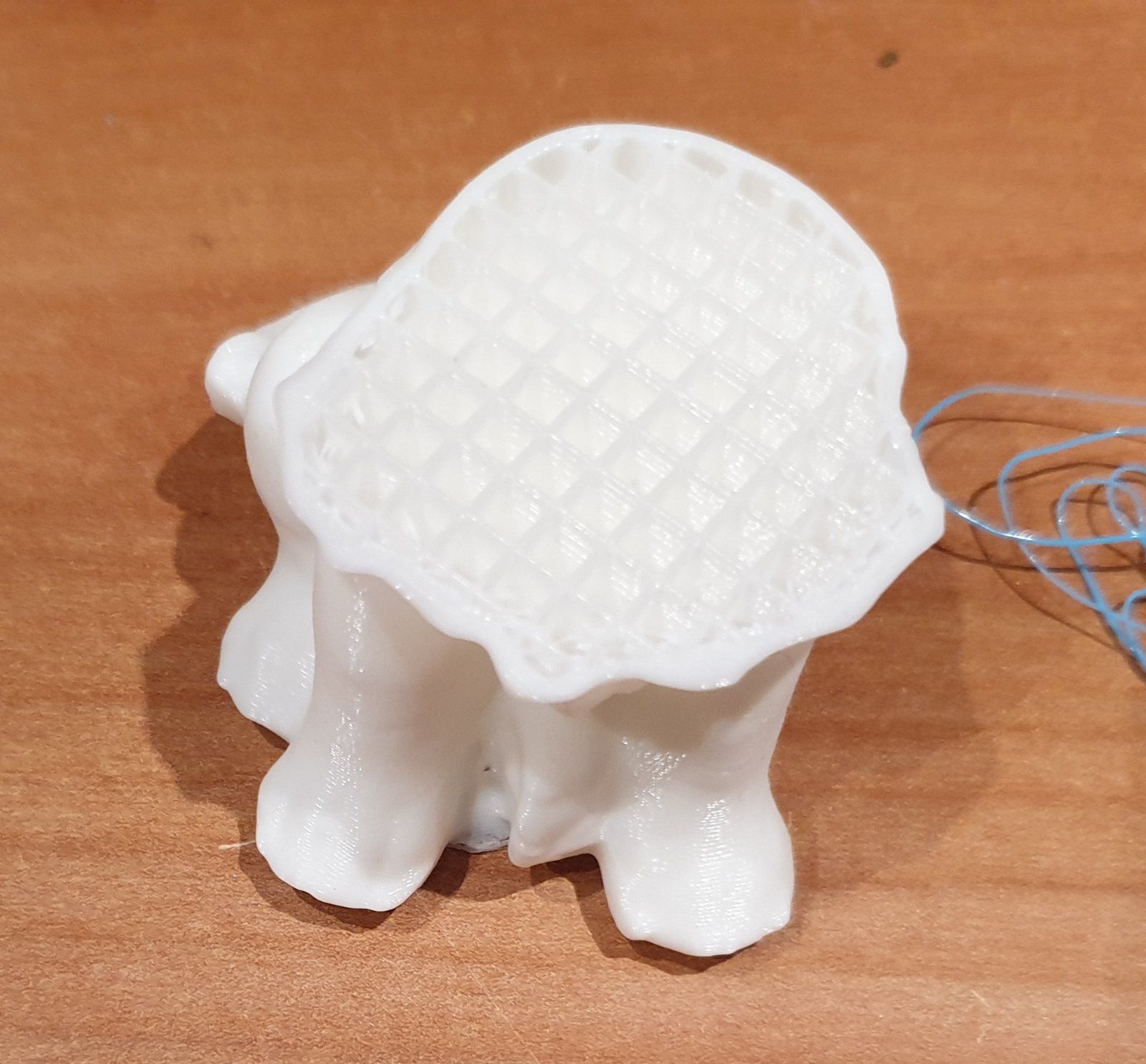

3. Attempt 1 - Test print started using white filament in box, but it wasnt enough to complete the print (pic below)

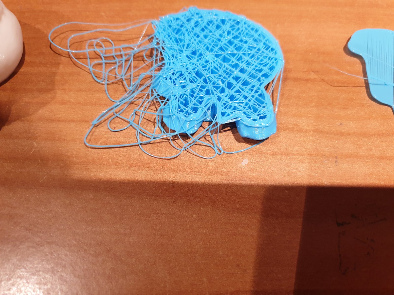

a) Attempt 2 - was ok for a while 20/30 mins then went all over the place (pic below)

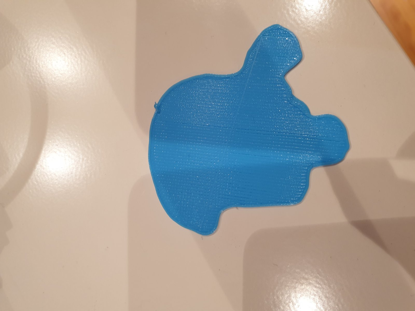

b) Attempt 3 - started but noticed gaps between lines on first layer so print cancelled. (pic below)

Attempt 1 -We went through and printed the test on the provided SD card with the test filament (white) but that ran out before it finished. It looks like it was going to work (see pic below)
Attempt 1
Attempt 1

Attempt 2 - was ok for a few layers and then went crazy (see pic)
Attempt 2
Attempt 2
Attempt 3 - aborted print as I could see gaps between lines on first layer and didnt want to waste more filament.
Attempt 3
Attempt 3

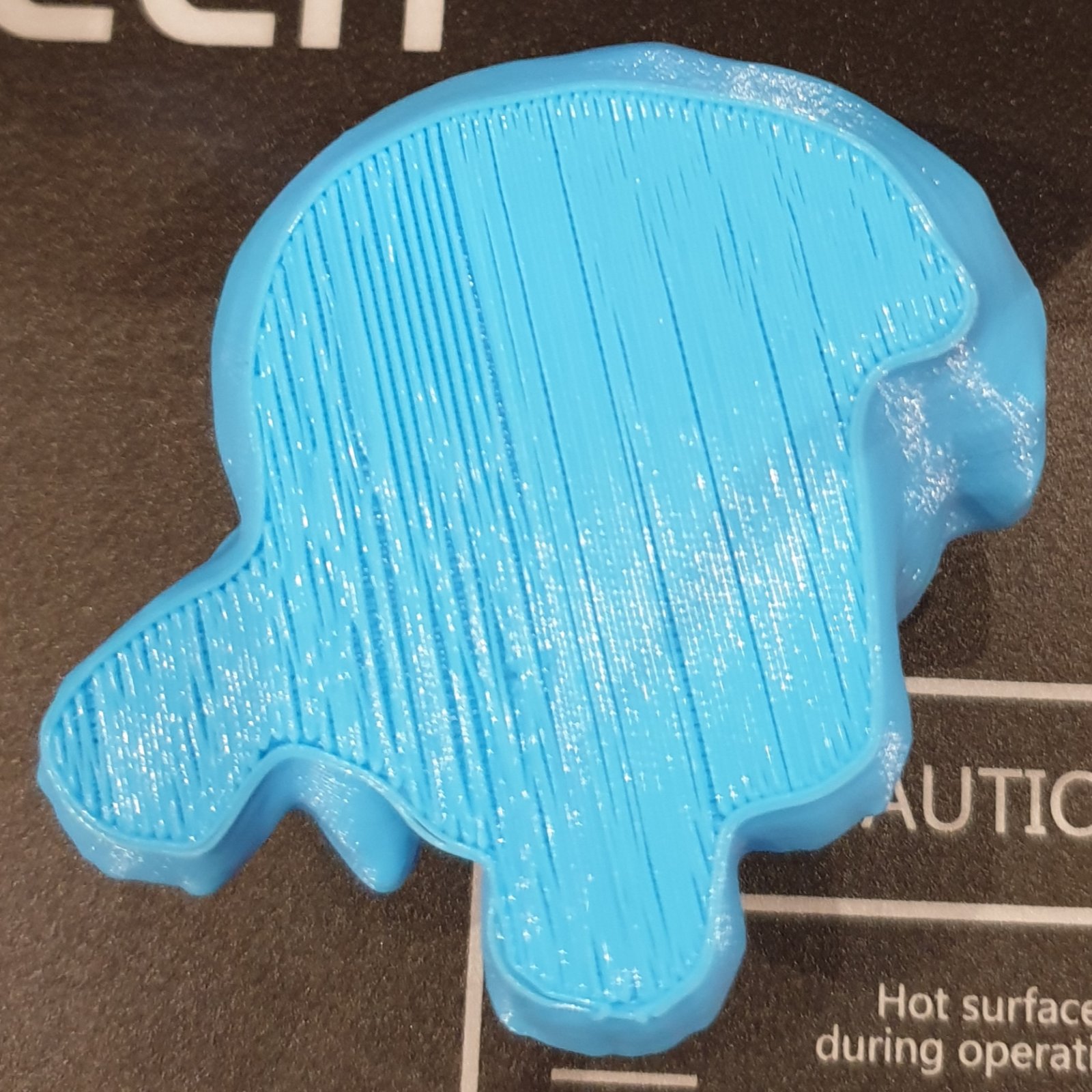

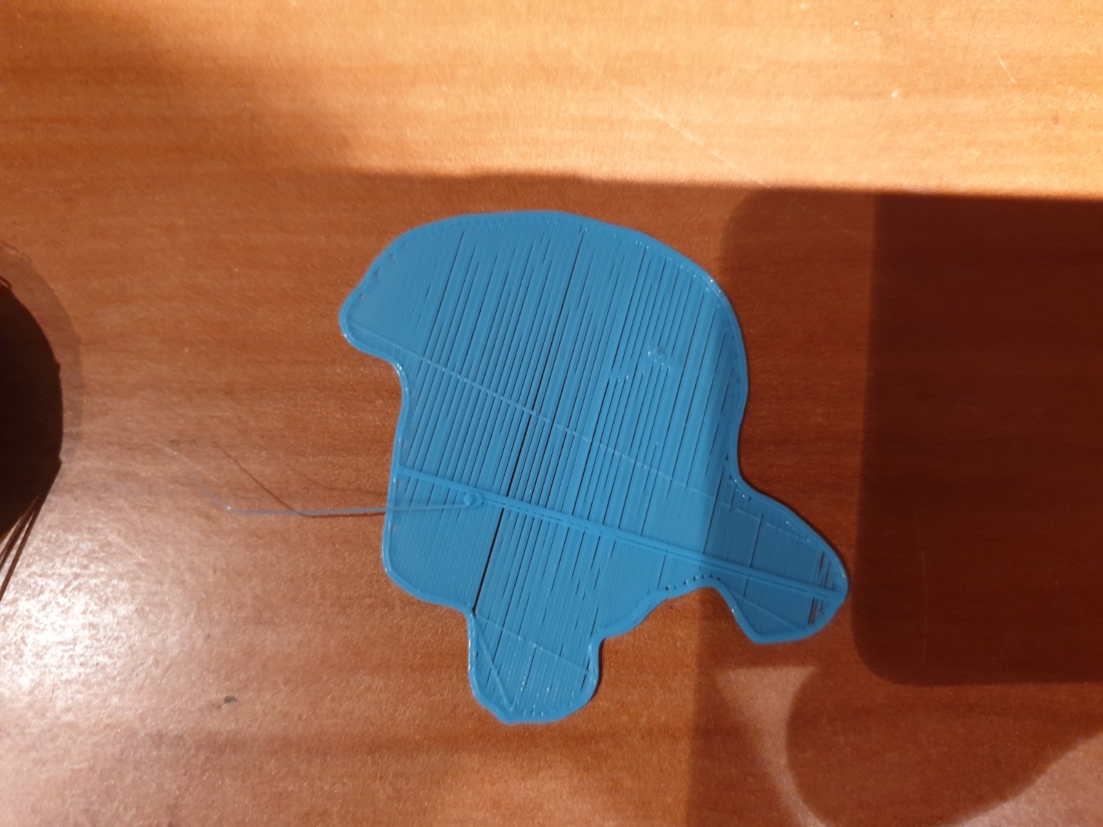

Some pics below of the best attempts I had today
Dog
Dog
Dog 2
Dog 2

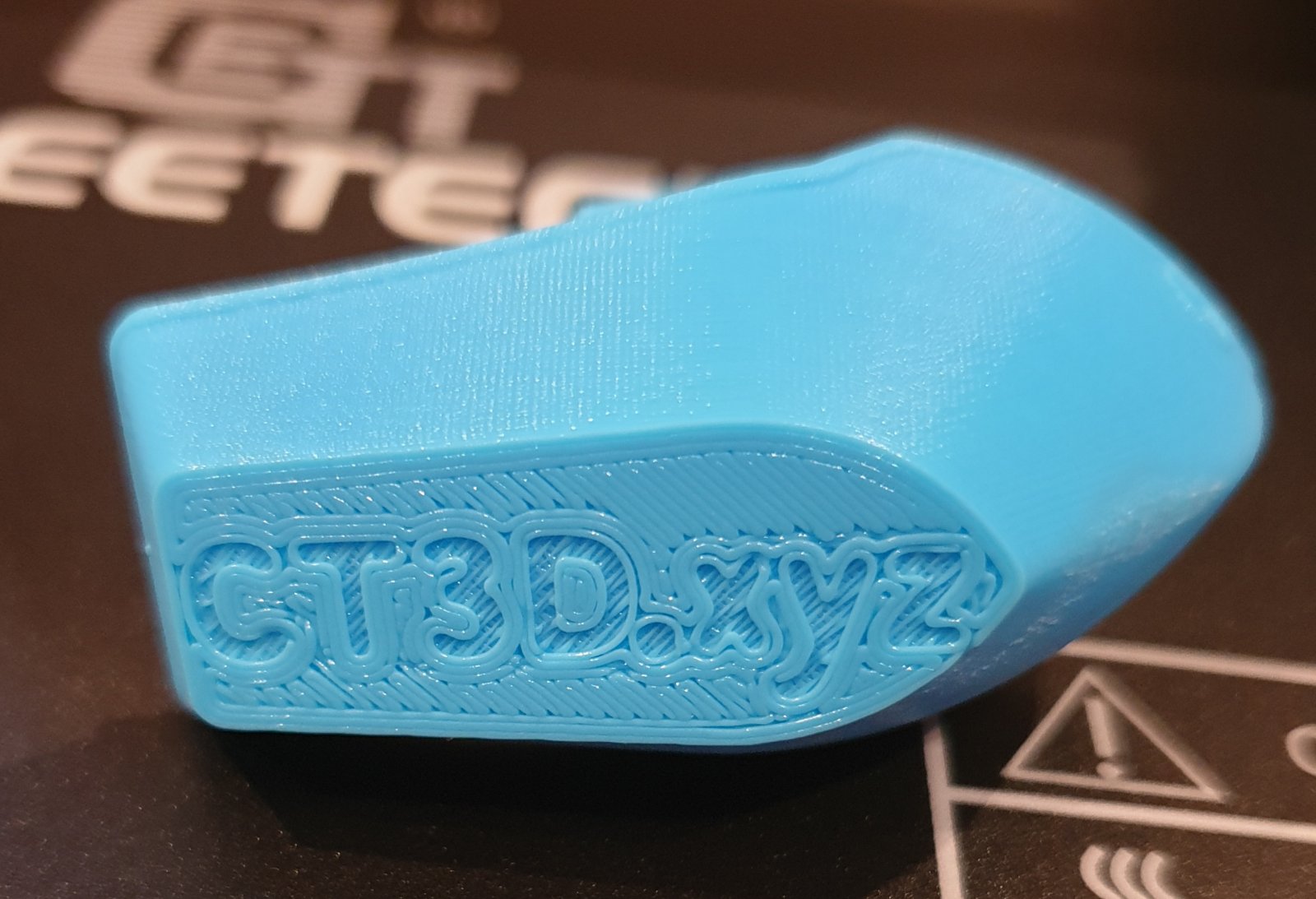

Hi guys, thanks for the help looks like it is sorted :D
You were right it was all down to levels I was a little far away on one side, not sure how I didn't realise this a few days ago. Updated pics below, thank you for the help.
