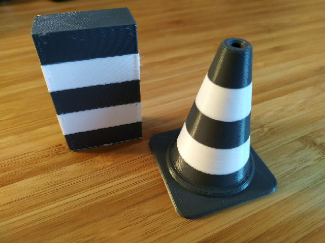

mleeber wrote: Tue Jan 07, 2020 11:07 pm SO I am on a mission to find a slicer that I can invest the time in to learn and reap the benefits of successful and beautiful multi-color prints
Hello,
Buy Simplify3D - 149 USD (You have 2 weeks to change your mind and refund)
The prints are perfect at the first time, without losing time in tweaking parameters, endless.
Printed in 0.3 mm yesterday, with the default Profile for A20M :
Best regards,
Christophe

Aannea wrote: Mon Jan 13, 2020 7:07 pm Hello, do you have fff file ?? , I can not print It like yours.
Thank you so much.
Hello,
I have just used the default settings for A20M, available in Simplify3D
No modification at all. Just the settings, out of the box.
Is your Slicer Simplify3D?
Best regards,
