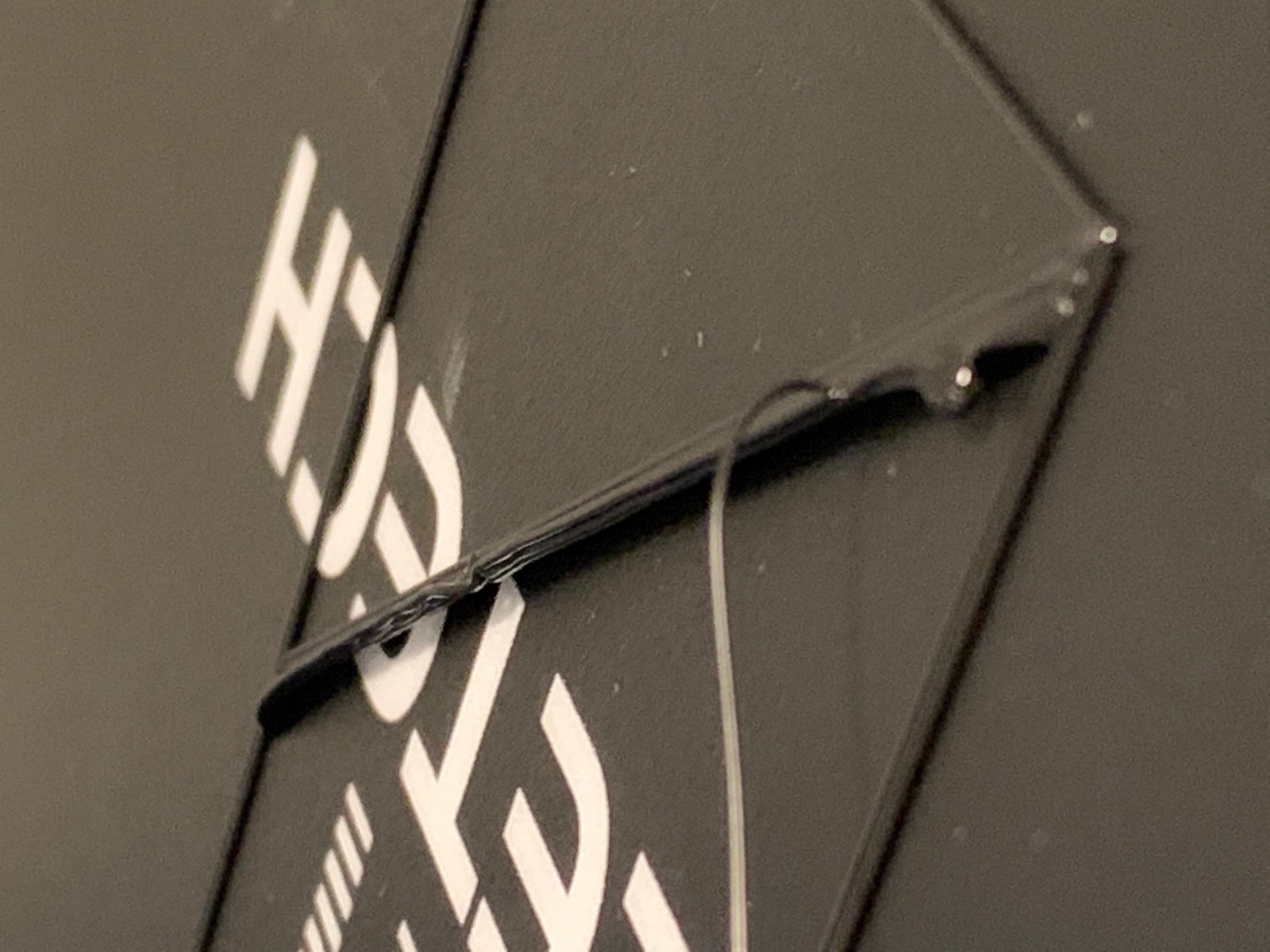

I am new to these but I have been trying many things already asked on previous posts.
The first test I could made with the filamente provided was fine (even if there was not enough to make the whole figure)
After that I ordered a new filament as since that All my prints are not sticking properly in the first lyer. The lines get bent, and after that the nozzle rubbs them over.
Is it maybe because I am using Pla+? I will pos a picture so you see what's going on. Bed temp is 60, and Nozzle is 200.
I tryed to use hair lacquer also with no success. I cleaned the bed with isopropilic alcohol too...
The corners are fine, the bed is completely flat. I can pass a A4 paper under the nozzle with a little pressure (how much pressure?)
Thank you

This is how it looks

I see. I think that I selected 0.4mm in the filament just because I thought this was the nozzle specifications. I guess I should choose 0.2 or 0.1 right?
May I have a screenshoot of your normal configuration on cura or easyprint software?
Thank you!

Hallo
Das beste Mittel für eine gute Haftung ist 1:1 mit Wasser verdünnter Holz Leim ( KEIN WASSERFESTEN )
dünnauftragen , trocknen lassen hält super
