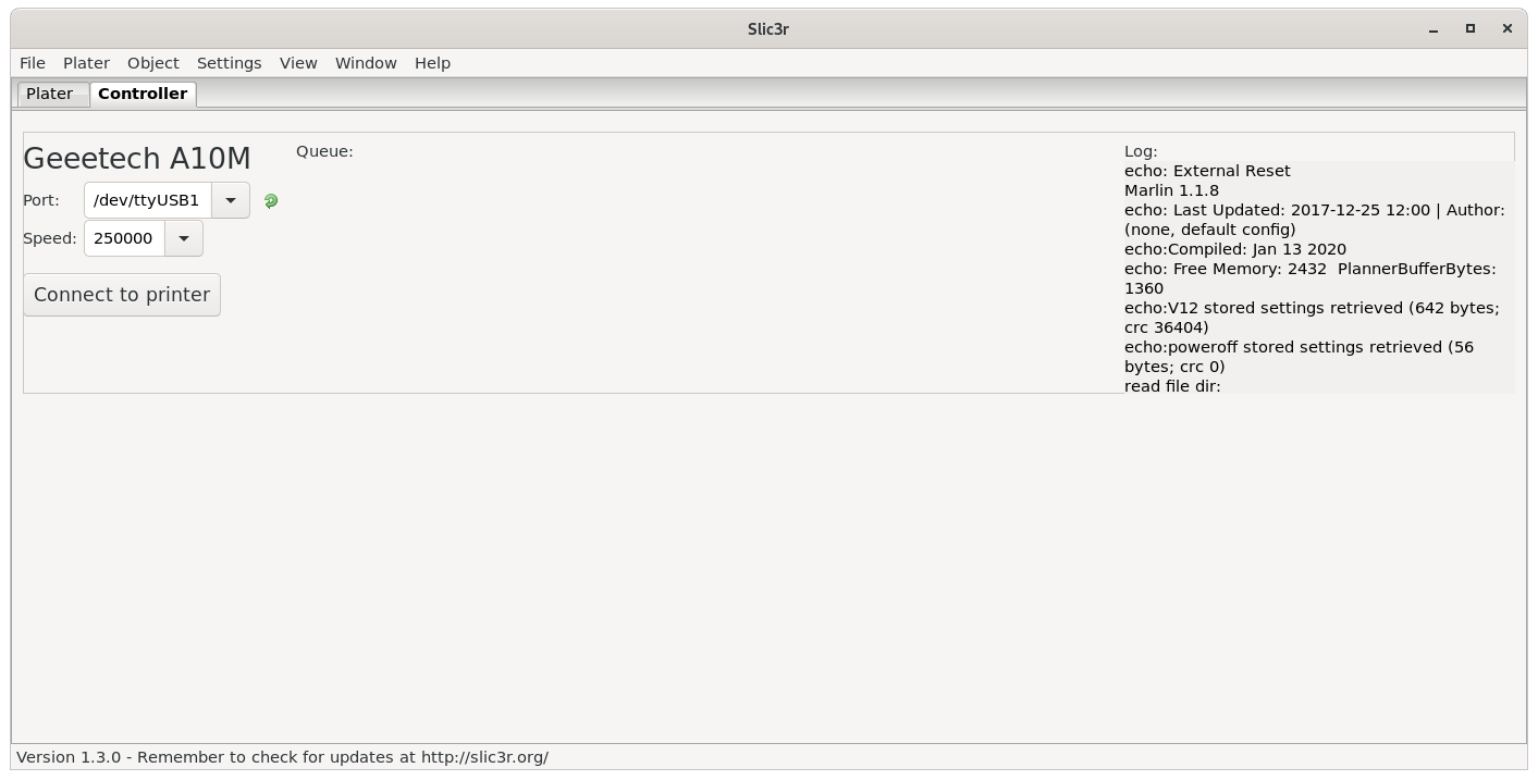

Hello, I have a Geeetech A10M for about a year. It was working fine. I tinkered and uploaded the firmware numerous times in the past with no problems.
However after the last firmware install, the printer became unresponsive and throws a lot of crc errors. Any ideas how to fix it?
Code: Select all
echo: External Reset
Marlin 1.1.8
echo: Last Updated: 2017-12-25 12:00 | Author: (none, default config)
echo:Compiled: Jan 13 2020
echo: Free Memory: 2432  PlannerBufferBytes: 1360

crc error: 10 != 0

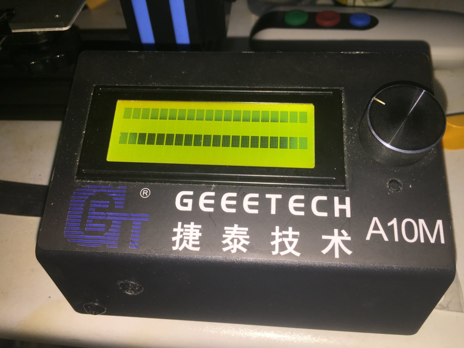

The screen & menus are unusable.
