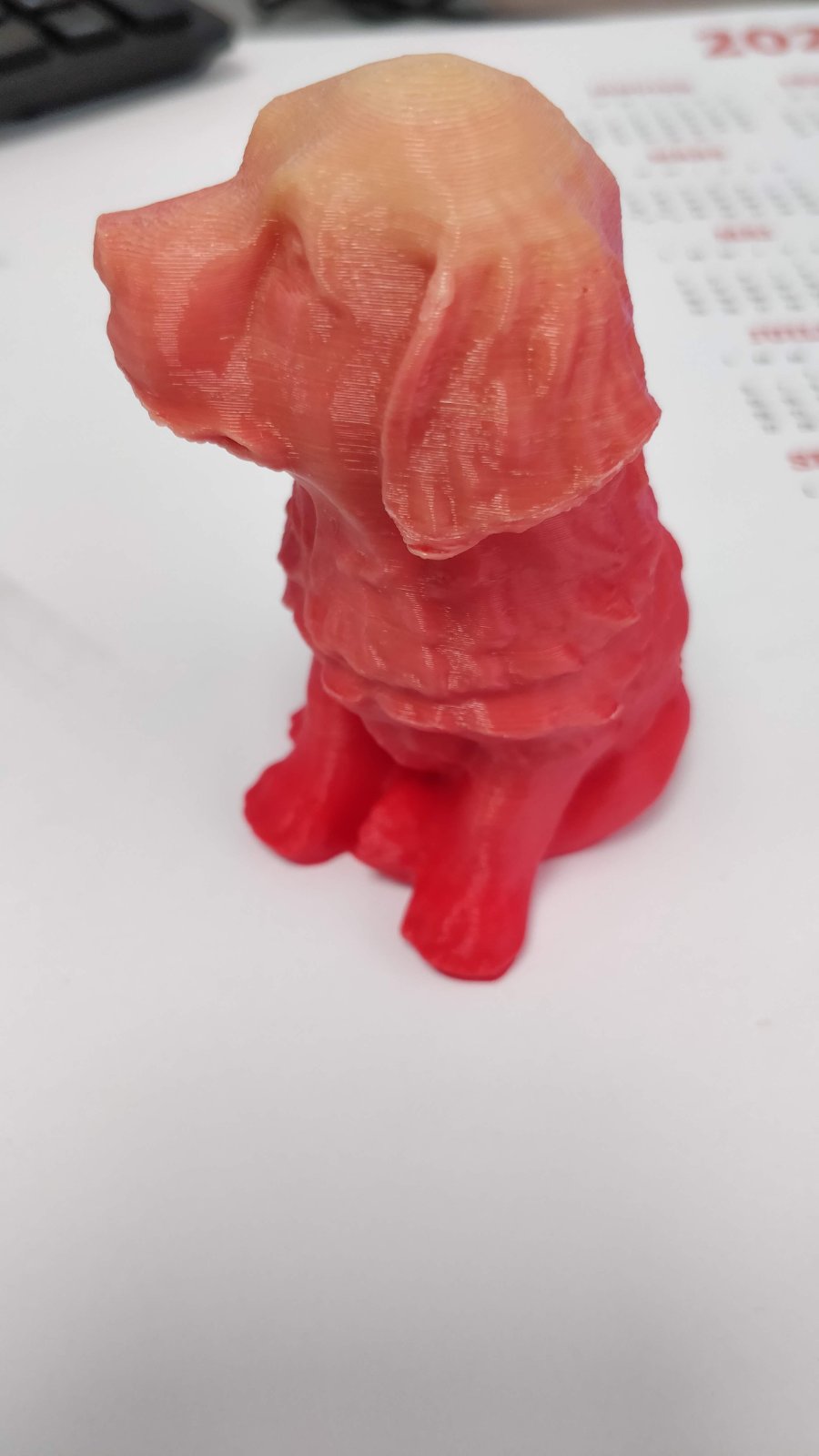

First print, demo model ( Dog ). Good quality.

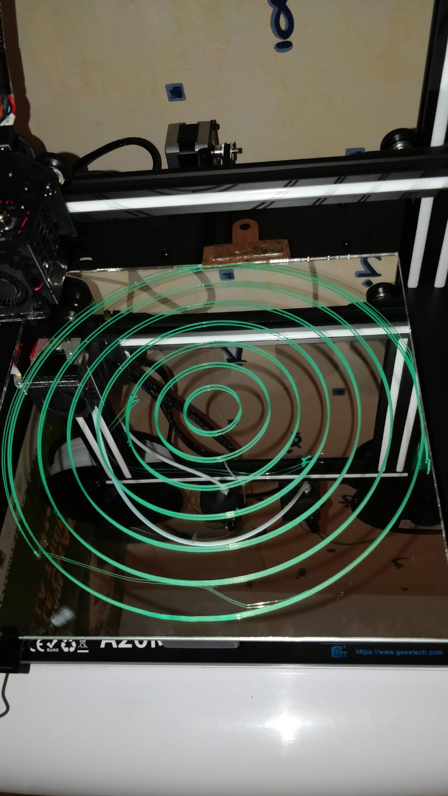

Next I have install my 3d touch and I have flash the firware with the .hex file find on geeetech website ( https://www.geeetech.com/download.html?download_id=33 ) and I have decided to print a model to see if the bed leveling is correct https://pinshape.com/items/44727-3d-pri ... evel-check.
At this moment my print is offset from bed.

With this change the nozzle is center when I make auto home but if I make G28 X 127.5 Y 127.5 the nozzle is not cente, it's shifted to the left.
And if I move X axis until the limit switch the X axis is +36 (is in abutement) and if I move the X axis at 255 the nozzle is 36 before the end bed
