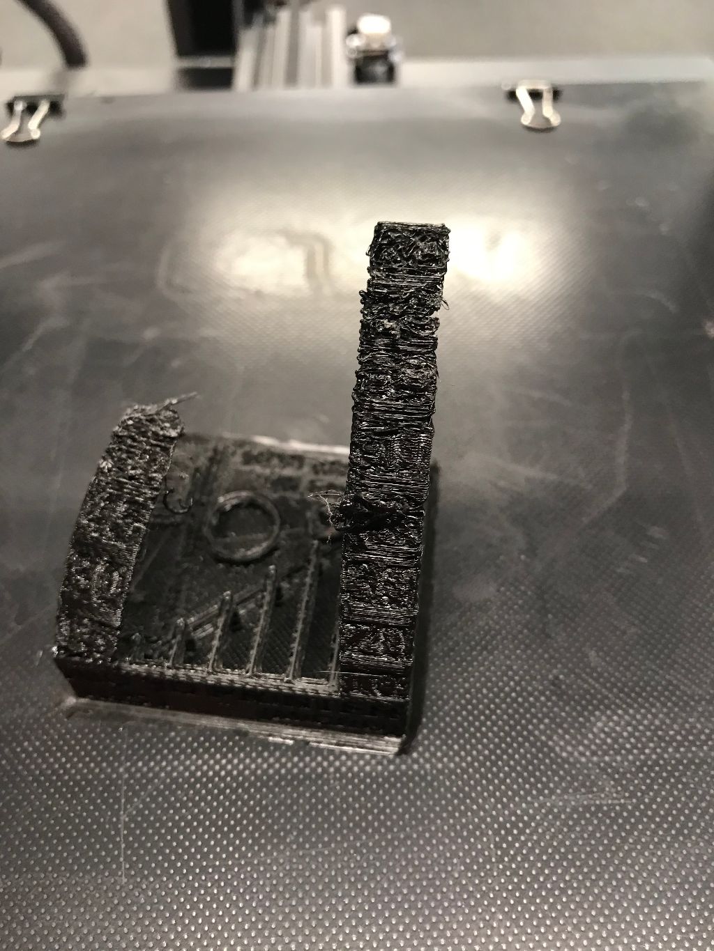

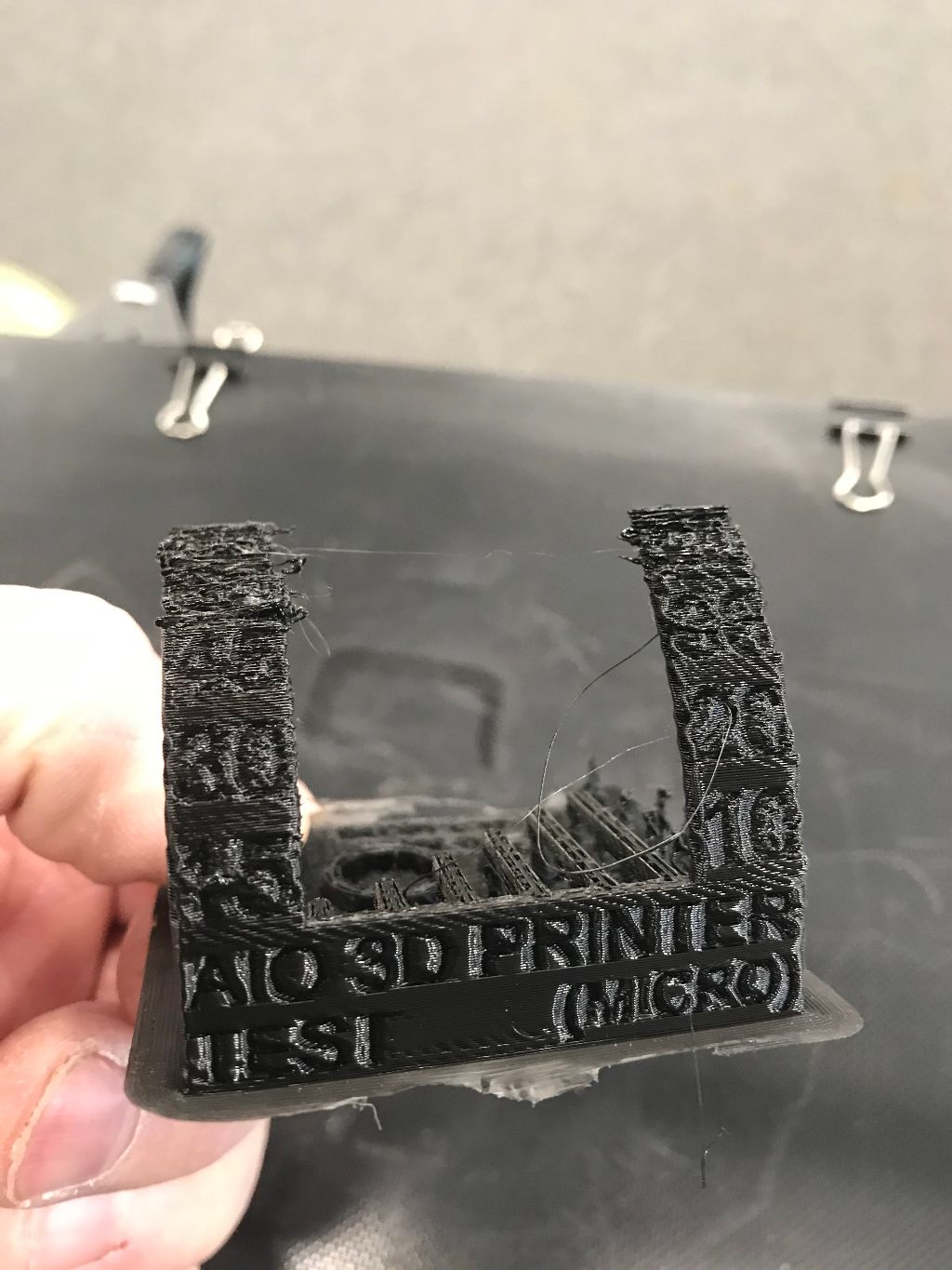

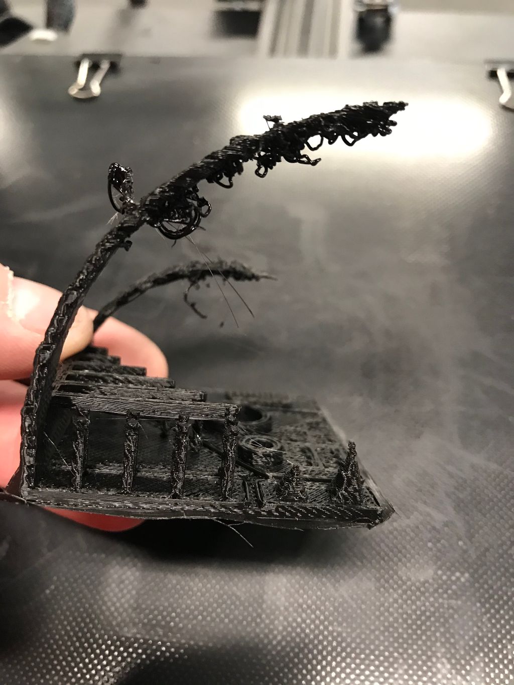

I can not get this dialed in. I am getting good prints in the beginning layers and then it starts to under extrude "I assume" about 6-10mm into the print. I have just replaced a new hot end with new nozzle and still get the same results. I am printing PLA at 205, have the esteps set to 430 "which helped some", the drive gear for the filament is not showing grinds on the teeth, I have tried an estep calibration and if I set it to extrude 100mm of filament I get 40mm extruded. I know when I got this that the esteps were around the 320's and it printed the dog great and several other prints, I didn't change any settings and the printer sat about 6-8 weeks and I cant print the dog without the infill crushing very easily. Has anyone else had this problem or know of a fix. I see a lot of people with under extrusion problems and I checked out a lot of solutions but no help. Here are a few pics of a test calibration that I printed out.

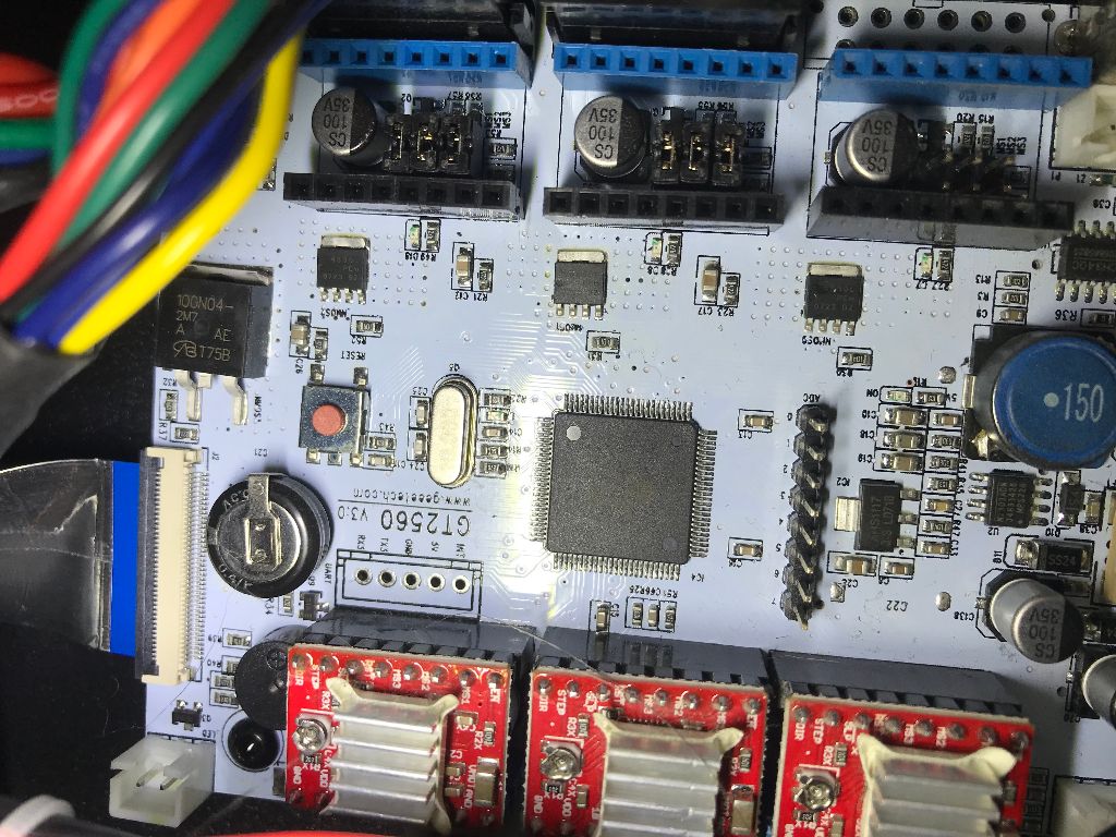

Thank you, I will look into that tomorrow. I forgot to add that both extruders are giving me the same results. I’m assuming the same jumper would have to be not making contact on both extruders.
Re: Under extrusion
I took the jumpers off and they all were getting contact and I put them all back on and I still get the same results.
