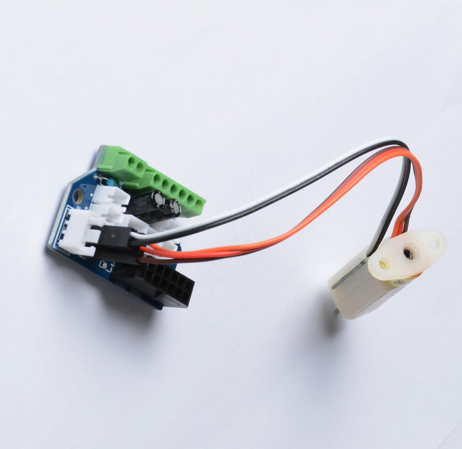

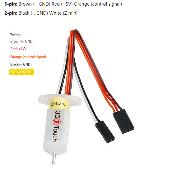

i have received a new A10 and a 3D Touch. But i cannot find any document or picture how to connect. All videos or docs are with the 5 pin header, but my HotEnd has a 3Pin + 2Pin Header. I assume this is for the 3D touch, named J13.
3D touch is 3IN + 2 PIN cable.
Can someone help me?

For the 3 pin the brown cable is at the top, for the 2 pin the black cable is at the top. Hope this helped, let me know if you need a picture

Yeah i had the same problem, looks like we got ourselves a newer model with different parts then the older 10M. As for documentation...there is none. Everything you find is based on the previous model so with the 3D touch it was a trial and error to find out but got mine perectly working now :D
