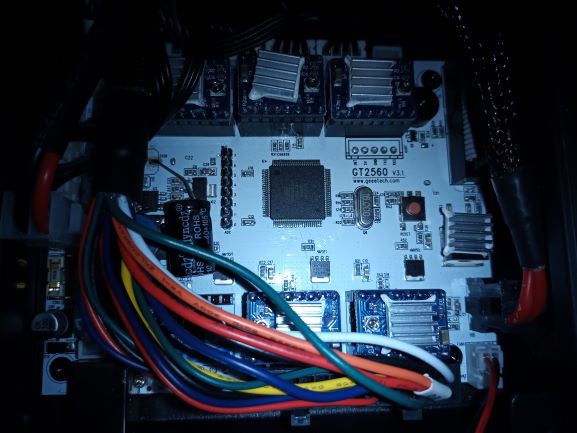

Hi VERT,
Apparently, the thermistor on the board was damaged. I found a damaged cable with a voltage for Hotend, which apparently touched the pcb where all the connectors from Hotend lead. I know that the printer showed me a temperature error several times and apparently the input on the board was damaged. Would it be possible to transfer the damaged input to other inputs and show where to edit fw? The entrance works, but probably not quite well.
FW I use your version of MArlin 2 build 477 setting 4 steps so the table will be fine.
Thank you Ales
Din0
Posts: 27
Joined: Mon Jan 27, 2020 9:33 pm
Re: HotEnd temperatrure
Post by Din0 »
Is there really no option to plug the entry elsewhere?
Motherboard I have gt2560 v3.1
Thanks
