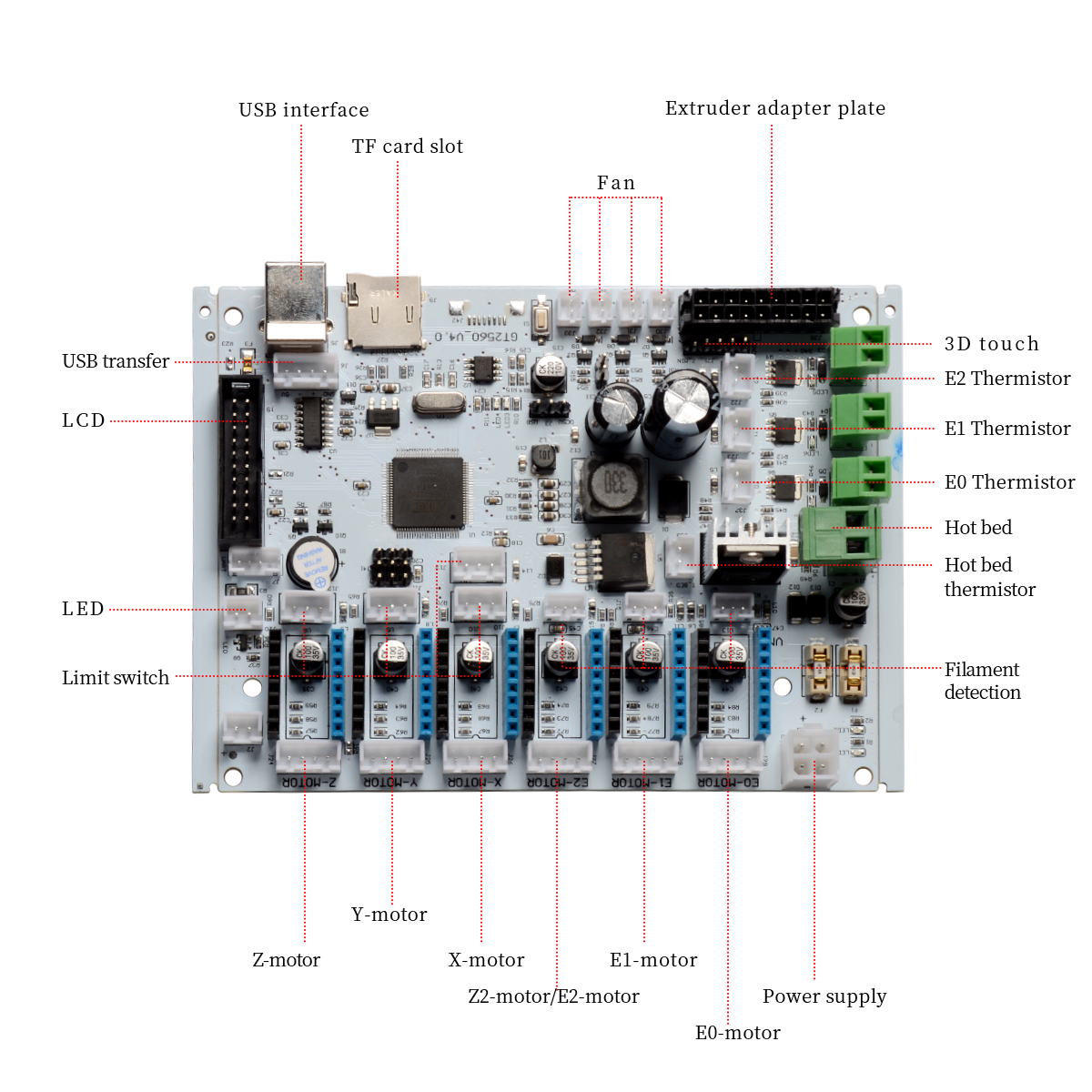

Hi, you can view it according to the wiring diagram:
GT2560 V4.0主板接线图.jpg (617.34 KiB) Viewed 9332 times

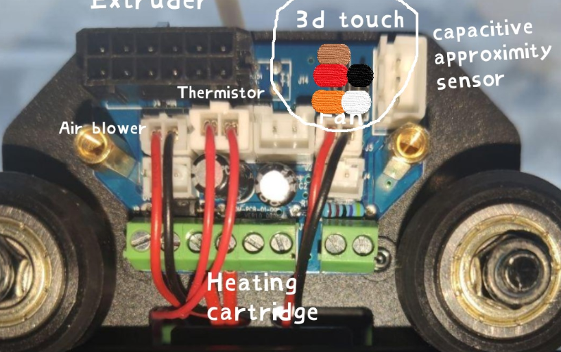

Thanks. I think is not clear my message. My issue it's with the part 3 in 1 out hotend kit for A10T A20T (SKU:700-001-1265).
Sometimes the filament go out, sometimes not. The temperature seams OK : 215 °C for PLA. Filent 1 it's working but the others 2 color nothig is going out. the motor pushing the filament it's working.
I have buy a new one to replace the existing. My printer is new and can't do nothing with. When I have receive the printer, the model from the card have work fine. Now also the model it's not print correctly.

Hi, Hot end installation,
You need to install the hot end into the heating cage,
For the transfer board part, you can refer to:
