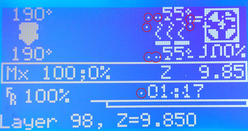

Display error found!

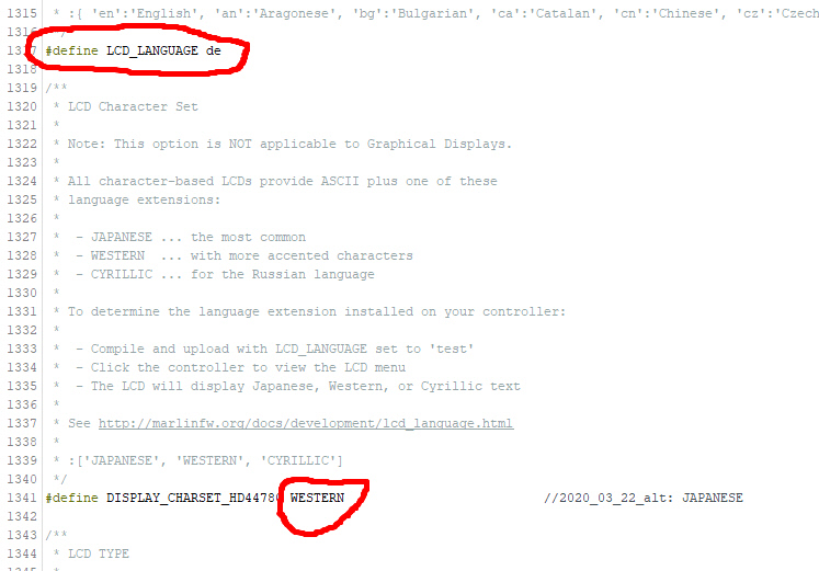

After switching to the language German in Marlin 1.1.8 I had massive pixel errors in the display (photo). With preparatory work for the conversion to Marlin 2.0.5.1 I came across the "display language" Japanese. This didn't seem to be plausible, because it can display most characters, but has to interpolate with German. That takes time. It was obvious to switch to WESTERN (see photo code) and the diplay is flawless again.
Change in code
Change in code
