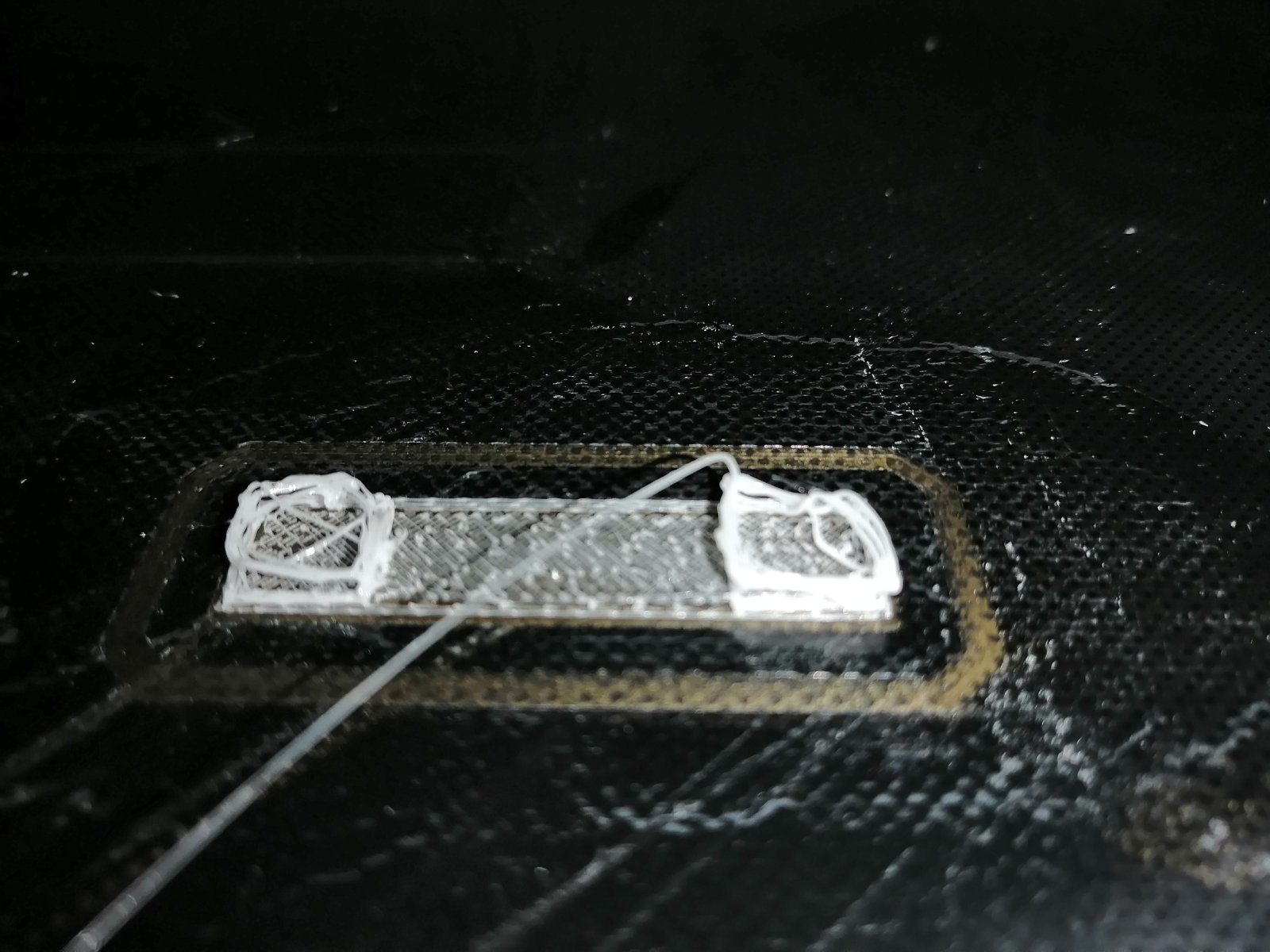

I have try to print a tower temp with a new filament. But my printer doesn't print.
Attached is a photo of a temperature tower that is not printed.
The nozzle is new and the ptfe change not long ago.
Anyone know where my problem is coming from?
Thanks
Thanks
- IMG_20200322_195031.jpg (236.45 KiB) Viewed 25397 times
Re: My printer don't print
Hi, level the hotbed before printing,
PLA consumable printing temperature is generally around 210,
The extruder can then be calibrated.

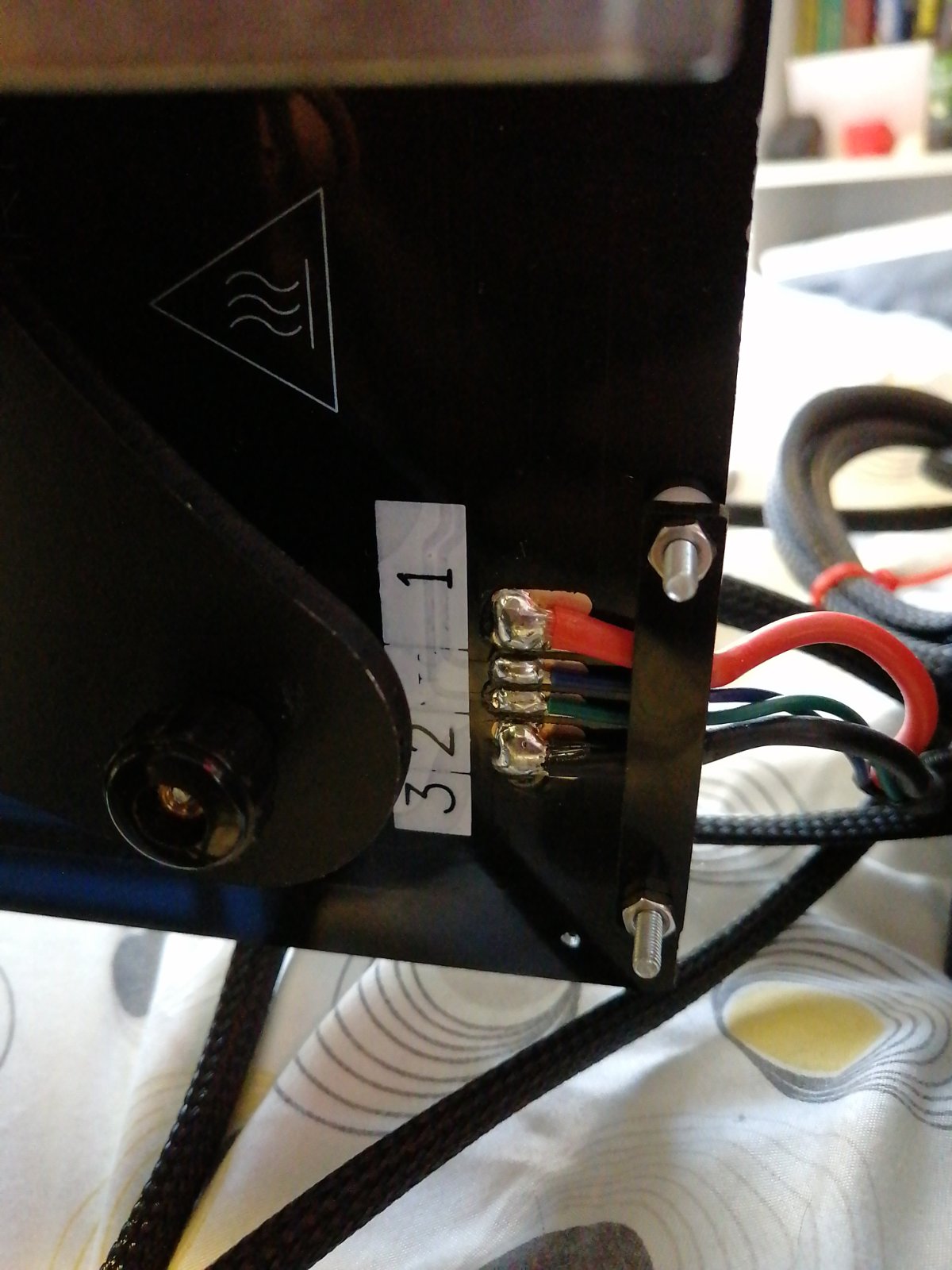

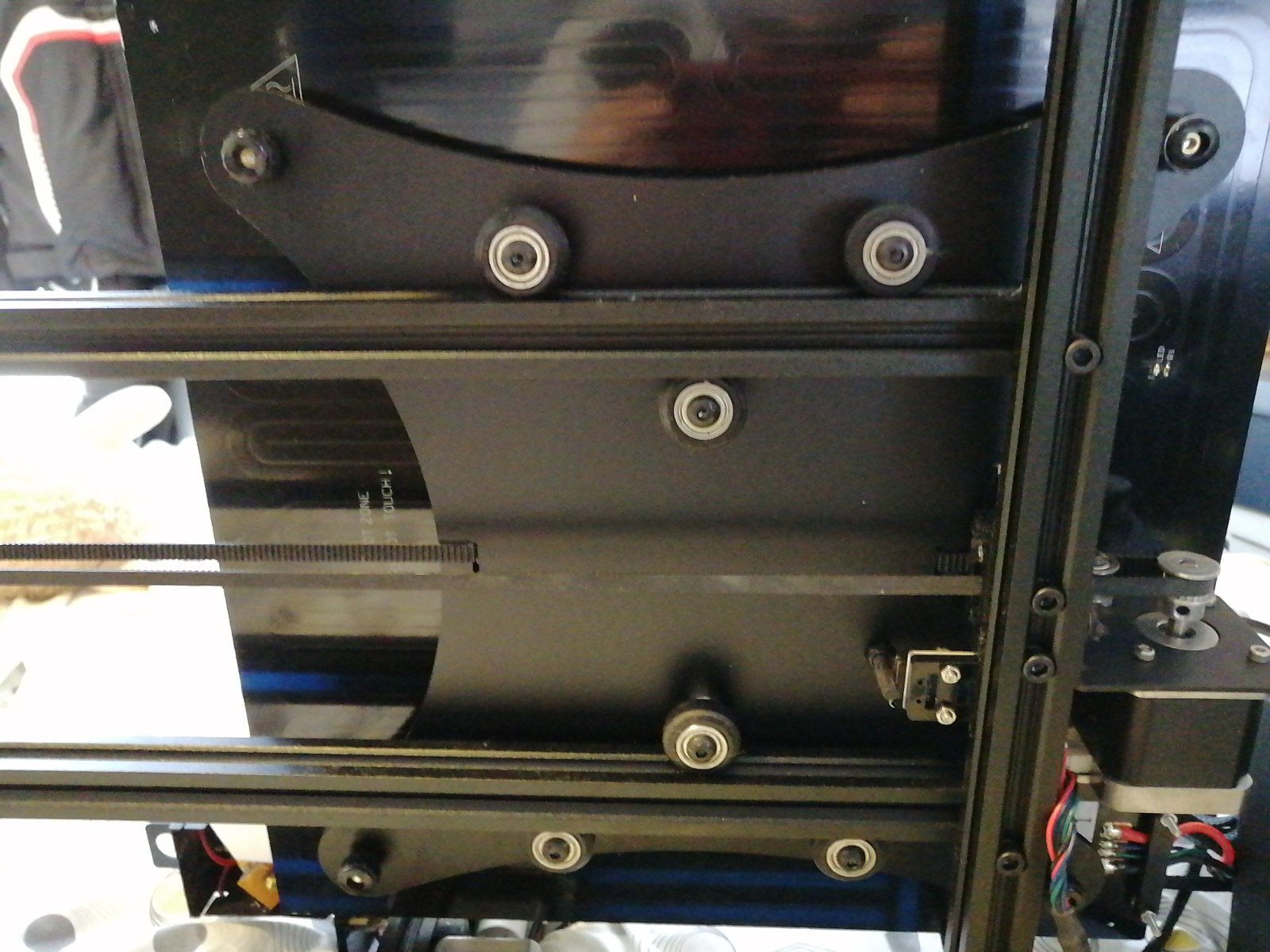

Where is thermistor?
- 15849617759733683405048783837664.jpg (291.54 KiB) Viewed 25381 times
- 15849617556847513282924076955917.jpg (224.32 KiB) Viewed 25381 times

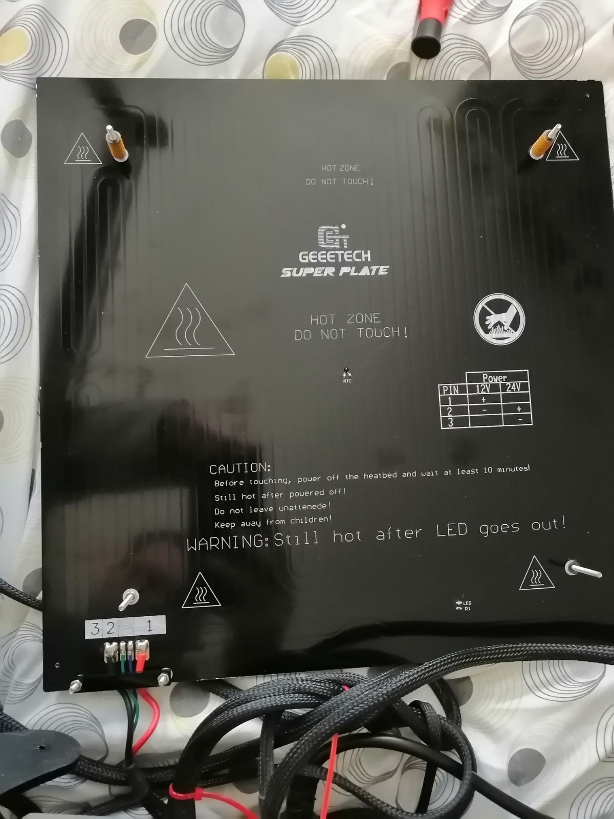

I have disassemble my heating plate.
- IMG_20200323_130446.jpg (257.86 KiB) Viewed 25381 times
