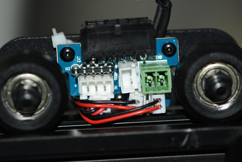

I got a A20M and have figured out that it is missing the thermistor. Where can I get one. Can anyone tell me which connector the thermistor plugs into? I think it plugs next to the green connector which goes to the heater itself. There is a two and a three prong connector vacant, and I suspect it does connect to the two prong connector. Any help will be very much appreciated. Hopsing

Hi, Can you provide a picture of your adapter board
What else is missing the thermistor
Hot end or hot bed?

Yes I can provide a picture but I don't know how to upload it. It is a jpeg file.

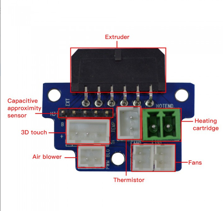

Hi, You can see if there is a heating rod,
You can refer to:

William thank you so much for the detail image. I thought that was the plug but I wanted to make sure. I now have a heated bed and heat to the nozzle but no movement from the stepper motors or extruder units. Any ideas as to what to check here? I am a newbie and I am sorry that I am a pain. Been trying for a month to get this printer up and working.
