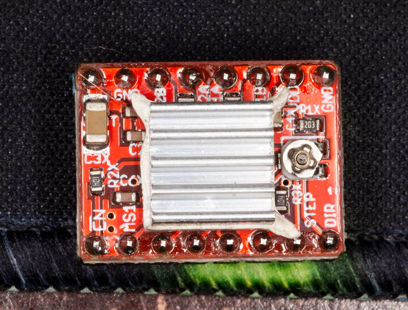

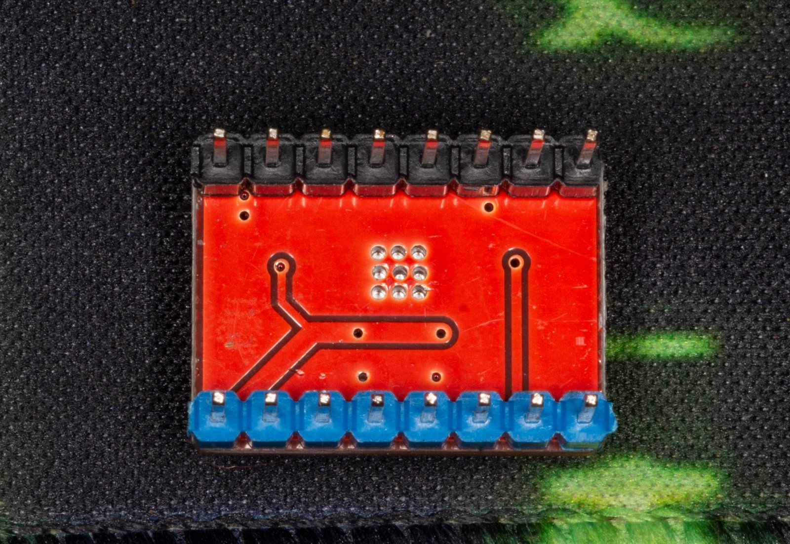

Ok here is a closeup shot of both sides of the driver board in my GT2560 v3.0 mother board. William do you line up the blue pins to the blue pins on the motherboard when plugging them in? Tht is the logical thing to do.
- driver board bottom image.jpg (438.65 KiB) Viewed 6384 times
- driver board image - top.jpg (421.8 KiB) Viewed 6384 times

yes, match it.

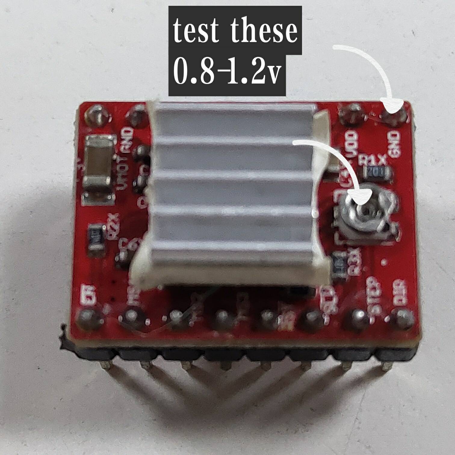

What should the voltage be set to on the variable resistor?
Re: Setting the current level on a A4988 Driver board correctly.
Hi, you can refer to this:
Decrease voltage counterclockwise.
Increase voltage clockwiseDecrease voltage counterclockwise.
