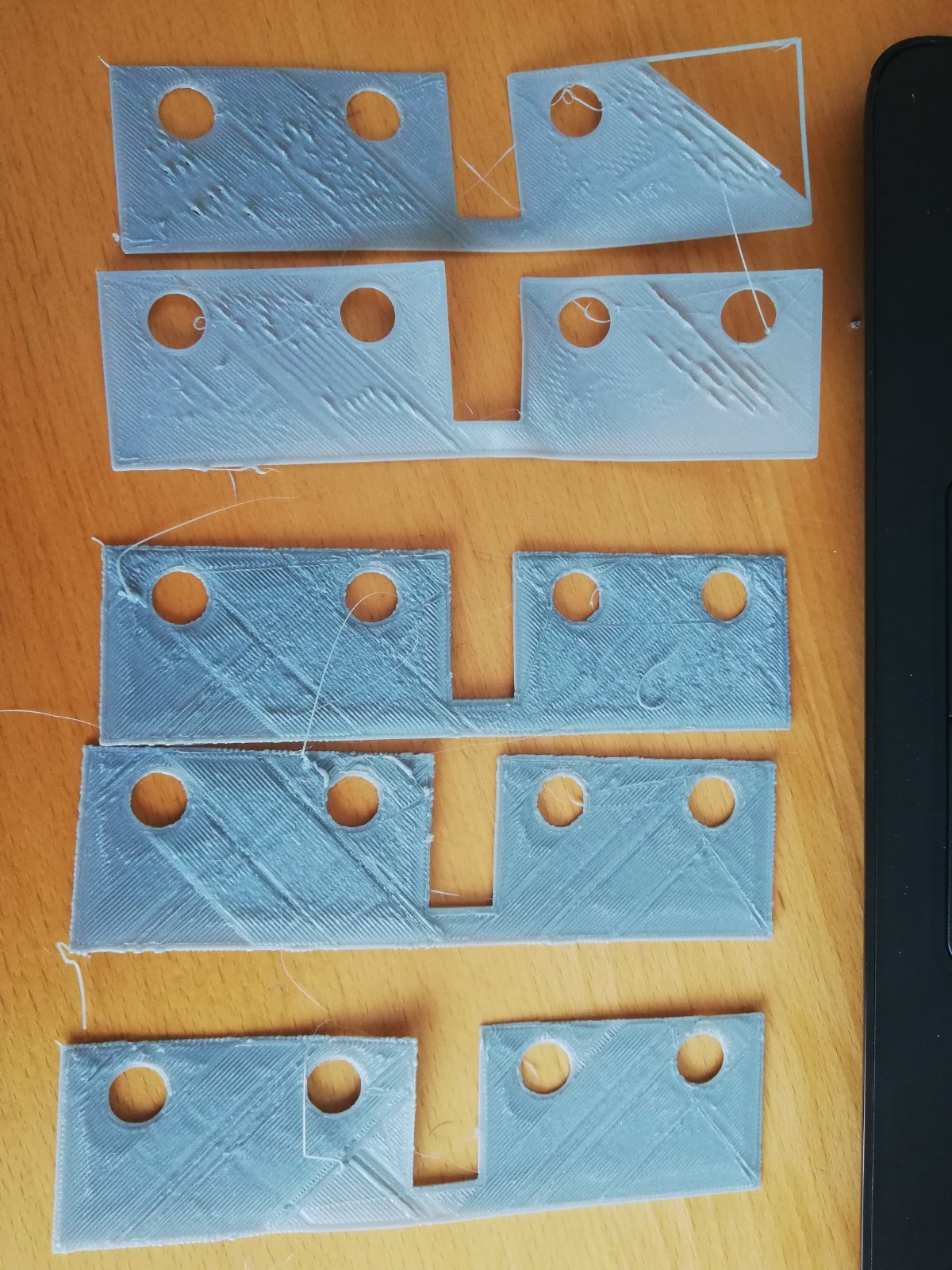

In the picture are shown some print trials, every trial another setup
- temperature from 190 to 210 °C,
- flow from 85 to 110%
- speed from 85 to 100%
result is always more than bad.
To me it seems that the changes havent taken place, because the extruder stepper seem to run same speed. Other parameters like temperature and flow Icant control visualy. I do have to believe in display.
I had PLA filament.
I tried also ABS with other setup before, the results were as bad as with PLA.https://www.geeetech.com/forum/download ... ew&id=7816

- IMG_20200413_125239.jpg (396.75 KiB) Viewed 13193 times
