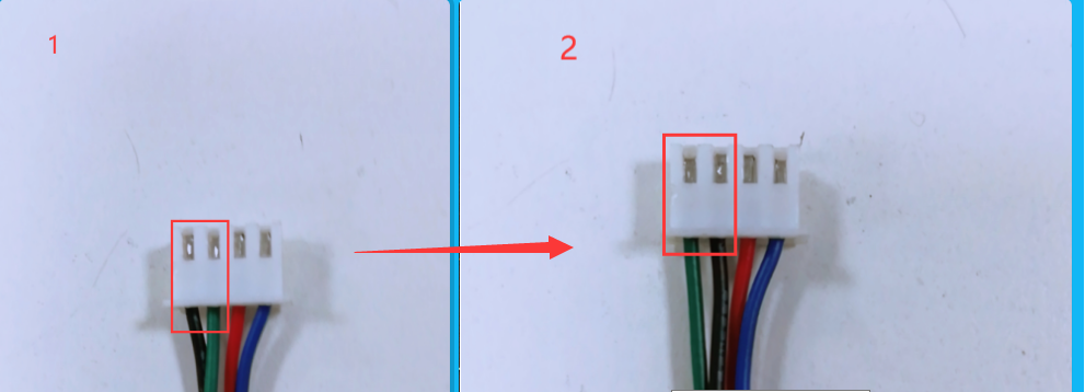

Hi,replacing the driver requires changing the firmware,
you can directly exchange the wire sequence to achieve it.
as the picture shows:
