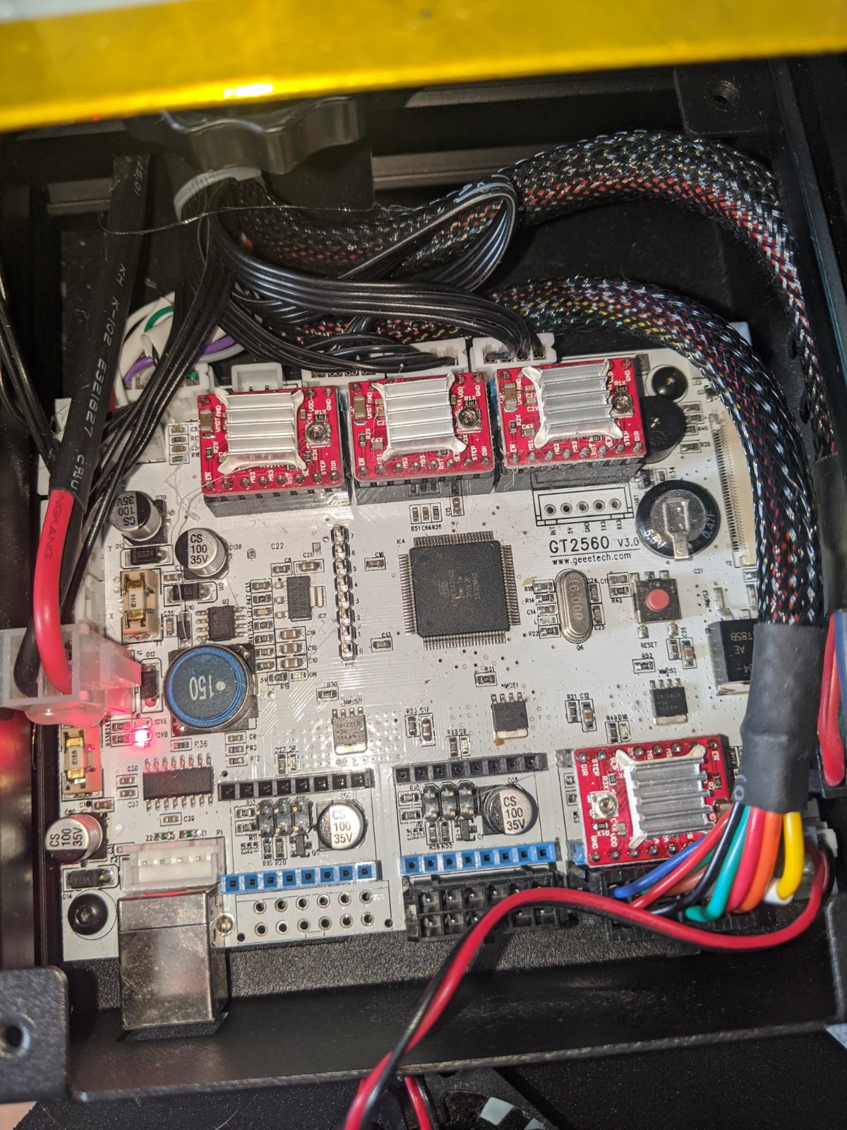

I recently got the Geetech A10 and have had a good few sucessfull prints but today i took apart the hot end to unclog it and i think it blew something. The printer powers up and i can hear the fan in running but the lcd does not power on so i cant check if it will heat up or select anything.
Really not sure what the issue is i have seen some on this forum and people asking for a picture of the motherboard lights so i have attached an image of that
Hope somebody can help i really want to get back to printing :(
thanks in advance for any replies
Ryan
Re: Geeetech A10 - Powers on but lcd does not work
Hi,you can check whether the line is not connected refer to this:
viewtopic.php?f=23&t=17040

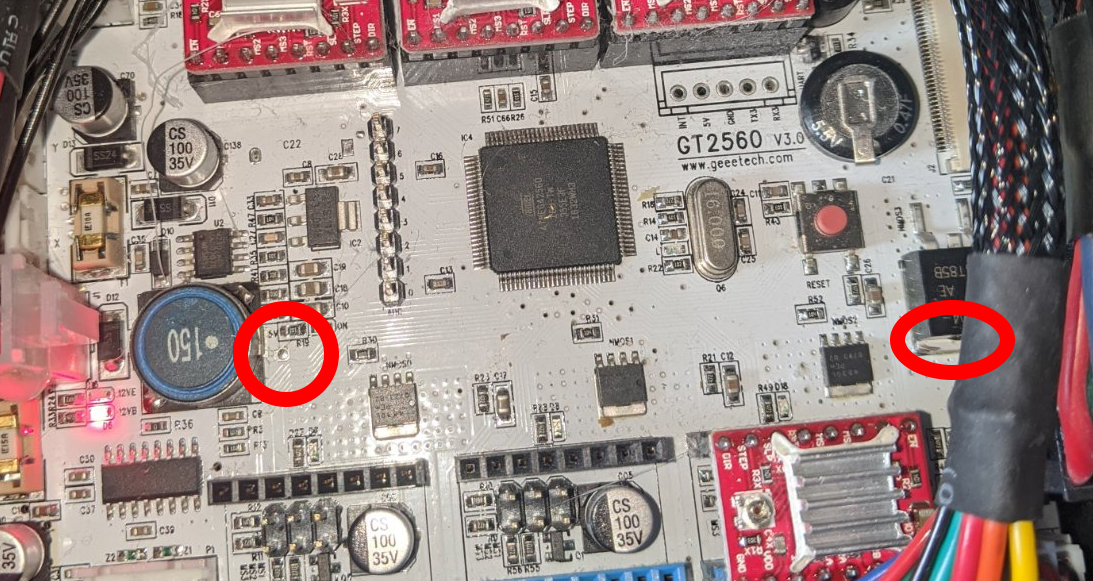

Hey,
These are the two points i tried to measure from like i said i wasn't too sure where exactly i should be measuring from. I did test the multimeter on a battery to make sure that it worked and it did give me the right reading, so at least i know that the multimeter does work
thanks Ryan
Hi,your motherboard is broken, you can replace the motherboard.
