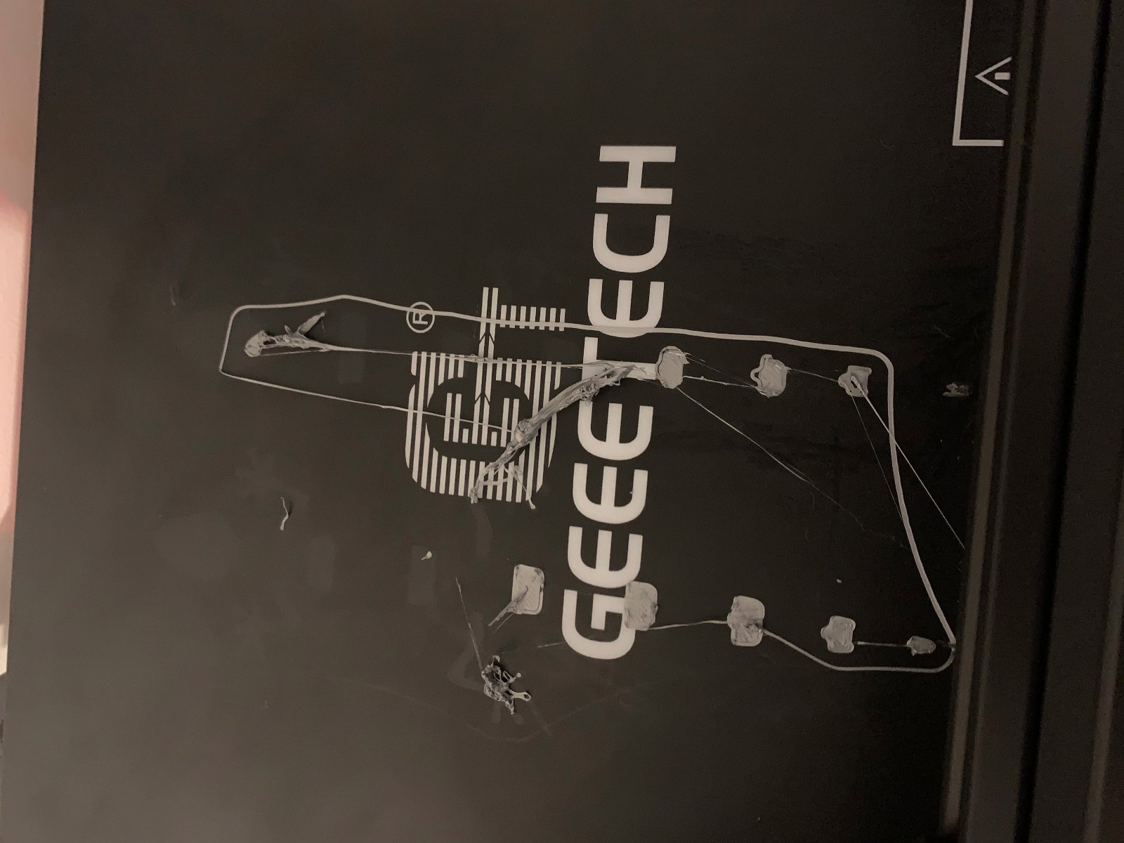

I can't seem to print using Cura. The gcode included on the SD works like a charm, anything else just does not work.
I'm using Cura 4.6.1
My A20M is on version 1.1.8 downloaded on Geeetech site
I'm trying to print the Articulated Lizard V2 (https://www.thingiverse.com/thing:3509154)
Screenshot_2020-05-02 Articulated Lizard V2 (Dual-Extrusion Remix) by Polymathic.png
Screenshot_2020-05-02 Articulated Lizard V2 (Dual-Extrusion Remix) by Polymathic.png (952.87 KiB) Viewed 4080 times
My bed is leveled manually but should be OK since the Dog gcode printed perfectly. (I leveled the bed several times to be sure)
I used the profiles found on the thread https://www.geeetech.com/forum/viewtopic.php?t=62065 for A10M
I tried to slow down the speed to 40mm/s instead of 60.
Heated the bed more
Heated the PLA 200, 210, 215
Tried several profiles of PLA
Nothing seems to work...
Here is the result I get:
Heating the PLA to 215 has a better adhesion but not enough to keep printing.

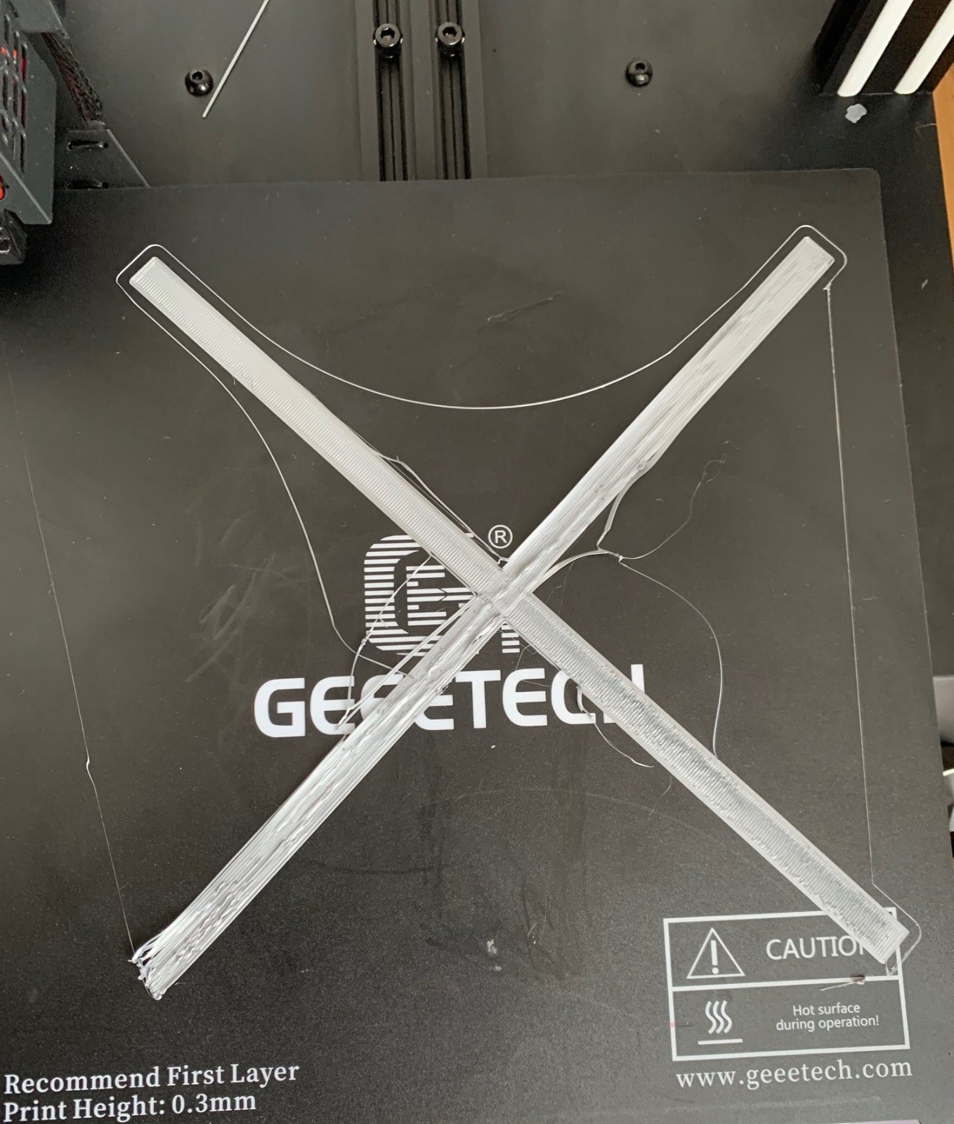

Problem solved!

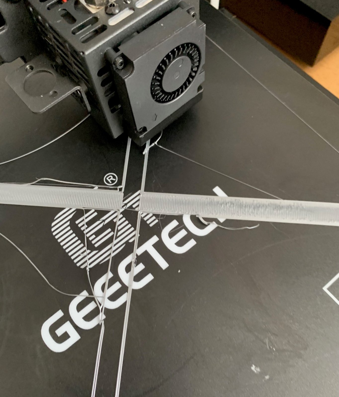

I should have listened to the several tutorials on YouTube... 90% of the problems with newcomers is BED LEVELING!!!! :oops:
I used this design to check how my bed was: https://www.thingiverse.com/thing:4077747 (A simple X shape for dialing in the first layer)
The result:
After a new bed leveling taking into account the results:
https://www.thingiverse.com/thing:214260
Now everything is in place and working!
Some tweaks are still needed... But I'm printing!
