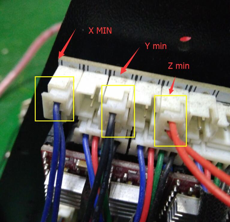

Hi,if the motor can move at one direction only
1)Check the wires of the endstop
corrrect endstop.jpg (60.15 KiB) Viewed 6204 times
2)You need to check the endstop work or not:http://geeetech.com/forum/viewtopic.php?f=17&t=60927
3)Swap the a4988
