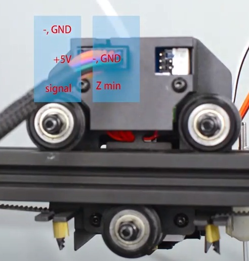

						Re: GT2560 Rev B + Set up 3D Touch
Hello, the hotend interface is shown in the figure.
You can refer to this link.
https://www.youtube.com/watch?v=bny4vqW8JtA
				- touch.jpg (56.16 KiB) Viewed 8247 times
So I don't seem to have this hotend interface I have seen the extension board is this the same thing? Is there no way to install the 3D touch without it? You would think if there was a model that wasn't compatible geeetech would have called it a different model/product.
