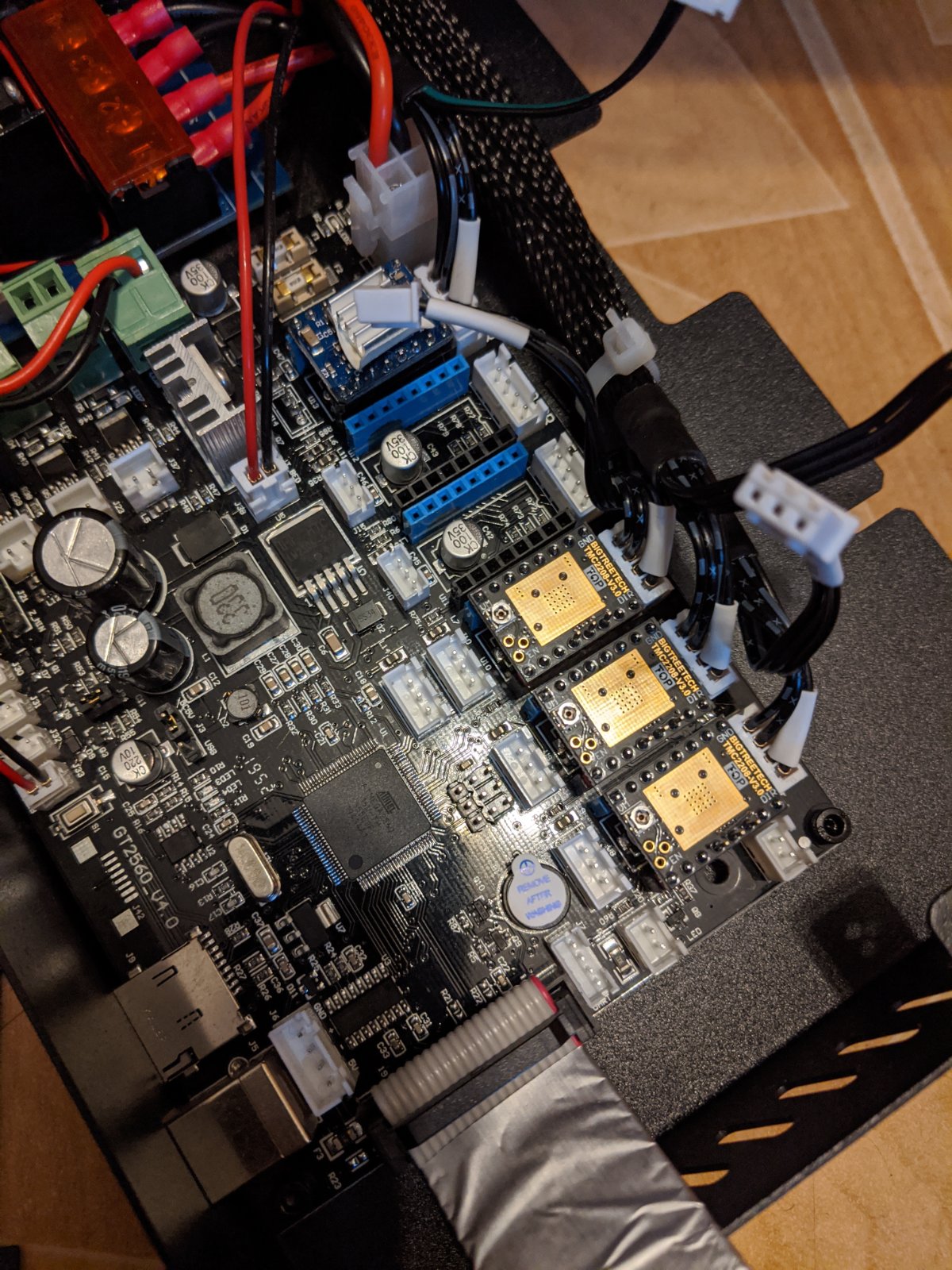

Also another qestion : I've unscrew the bottom of the printer to go on the psu and motherboard, and when i removed the bottom, i've unplug the fan of the motherboard, without seeing where it was plug on the motherboard... Can you say me where it was by default ?

I've just watched on my motherboard picture - fan is on j33 port, nearest left from TF card slot.
Just a few weeks ago i installed tmc2208 to, you just need to set the same voltage on them, just like on the a4988.
But when you measure the voltage (gnd pin on the stepper driver and the adjustment knob on it) you should disconnect motors from the board!
In my a4988 the were 0.9v on all axis, 1.2 on extruder.
