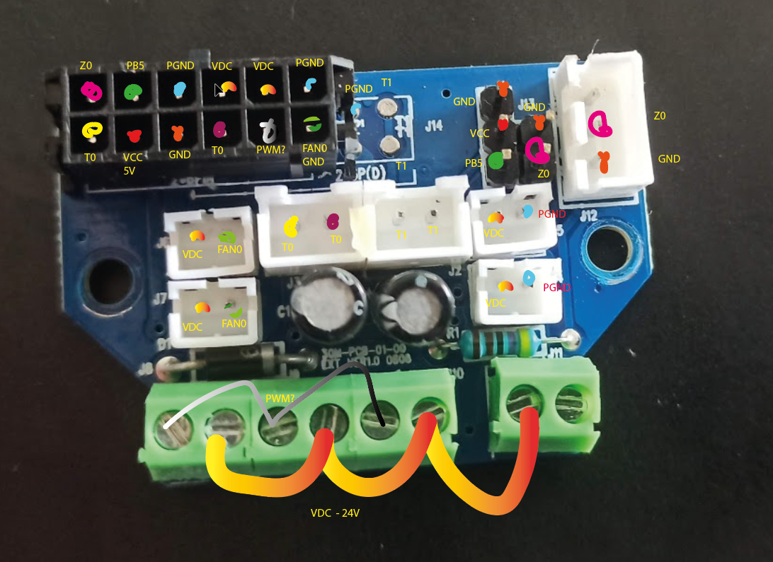

i could not find any resources to the "new" Mainboard GT2560_v4 and the Expansion board used in the A20m .
Are the schematics available somewhere?
I want to replace the GT2560 with a 32Bit board and need to unsderstand the cabeling.
Thanks, Thomas
Mainboard GT2560_v4 + Expasion Board Schematics
Re: Mainboard GT2560_v4 + Expasion Board Schematics
Ok, i measured it myself.. Find attached the pinout.
VCD is +24V
VCC is +5v
PWM? is the PWM-Controlled ( - ) ground of the Mainboard for the Heater 0
Fan0 GND is the PWM-Controlled ( - ) ground of the Mainboard for the Cooling fan
PGND is GND for all stuff that always works ( Like Extruder-Cooler )
t0 are the Thermistor 0 Pins - polarity does not matter
t1 are the Thermistor 1 Pins - polarity does not matter - if used
PB5 is for the Touch Probe-Servo Signal
Z0 is the Probe output of the Touch
VCD is +24V
VCC is +5v
- Expansion-V1 Pinout.png (1.19 MiB) Viewed 4582 times
