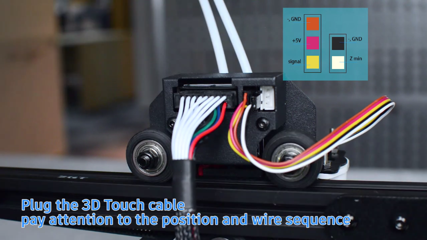

please try to reinstall the 3DTouch like the video: https://www.youtube.com/watch?v=4-Zofqk4Mvc&t=3s ?
Especially focus on the wire sequence, like the picture attached.
3D touch安装端口1.png (440.98 KiB) Viewed 2472 times
