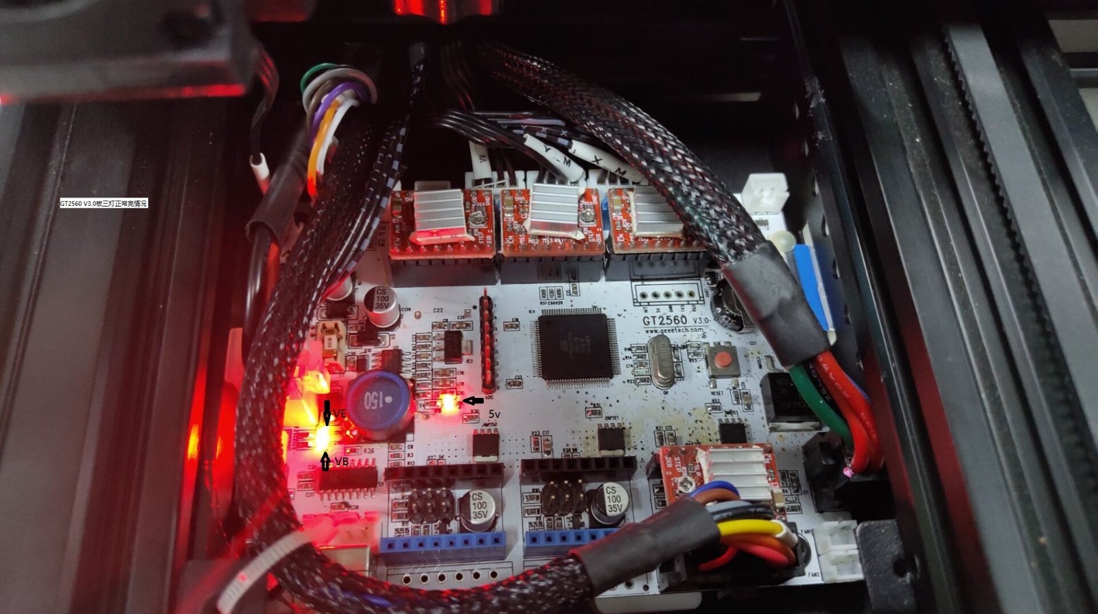

Hi, You can
  1. After replacing the fuse on the motherboard, check if the three lights on your motherboard are properly lit;
  2. Measure the output voltage of the power supply.
You can refer to this:
