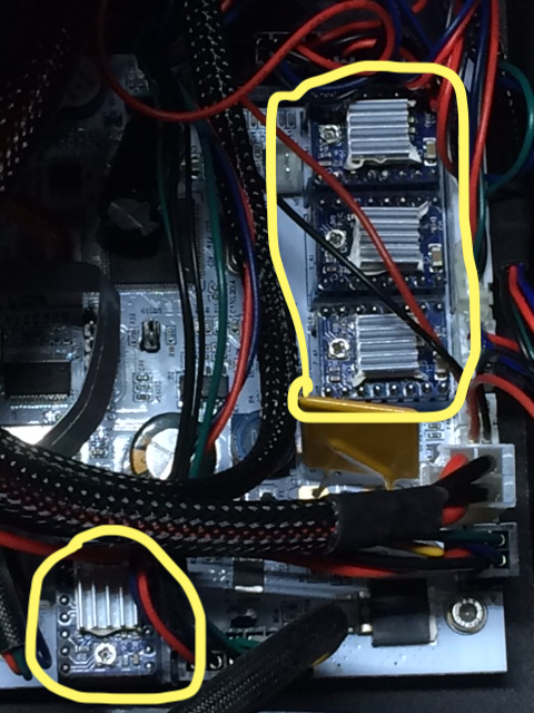

So just to be clear, all 4 little driver boards (1 by fan and 3 on side) are to be between 0.8 - 1.2V? Can I use the case as ground, like the inside of a screw hole that is bare? hard to get test lead to stay put on that tiny pin.

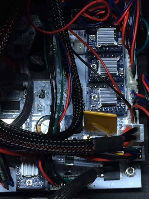

OK, I got all 4 driver boards to read 0.9V. The one near the fan (at the bottom of the picture) was reading 0.4v and I had to turn the pot counterclockwise to make it increase. Same as the middle one on the side, CCW to increase from 0.6V to 0.9V. The lower one on the side ( in picture) was super touchy, it was at 1.9V and I had to turn it CCW to decrease, yes CCW... barely turned and it was down to 0.5V, barely turned CW and it was back up to 1.6V... I managed to get it to 0.9V. Top driver on side was reading 0.9V.
So why were 2 drivers CCW to increase and the other CW to increase?? I'm not an electrical engineer, or circuit card expert.... please explain.

Hi, The driver board voltage ranges from 0.8 to 1.2V.
Increase the voltage clockwise and decrease the voltage counterclockwise.

If the voltage on one of the driver boards will not stay at 0.9V, it keeps dropping to 0.6V do I need to replace the board? it adjusts to either 0.6V or 1.6V... I barely turn it and that is it, I got it to 0.9V last night, rechecked all voltages this morning and it was at 0.6V. barely turned it and it went to 1.6V and back and forth between those 2 voltages.
