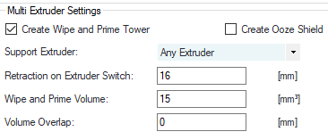

is there a possibility to change the size aof the prime tower in curaengine in Repetier Host??
I experienced problems when there are more then one filament changes in a layer.
The tower is getting too high, so that the nozzle bumps into it an the print-bed sometimes slips.

Hi. How do I manage the filament purge with a bucket and change in Cura?
I can only rectract, not purge using the new filament.

I'll Explain: I have a model that's made of 3 stl.
I can assign an extruder to each stl and print in 3 unfaded colors.
But if there's no purging the first trait of the new color in each strate will be faded with the previous.
I am asking: I am using I suppose a wrong g-code for the tool change. Is somewhere (i can't find it) a tool change Gcode to use a purge bucket with three extruders?
Thank you in advance.

Where can I change the size of the tower curaengine in Repetier Host??

ThomasGee wrote: Fri Dec 13, 2019 9:03 pm
there's a "purge volume" in the cura settings that, increased, increased the size of my tower.
The only problem is that the extruder drags on the tower offsetting the print.

@Sardauker,
Try a different position of the tower on the bed (x,y parameters).

Sorry, I can see in the settings of curaengine slicer (NOT CURA itself!) the possibility to change these pameters.
Only
