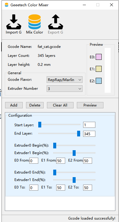

something about the three-color mix software
Color mixing software for multi-mixing printer
Scope of application: win7/win8/win10
Supported gcode from:Slic3r, Cura, Easyprint3d and simplify3d. (Other gcode may support, but did not test)
Currently only available for Windows systems

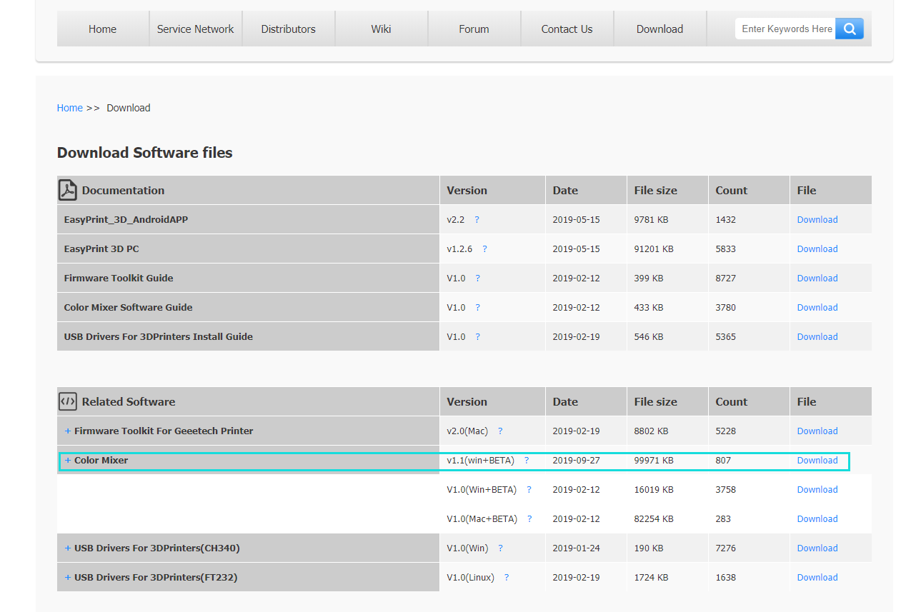

the download link is :https://www.geeetech.com/download.html?download_id=40
and choose this:

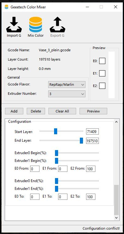

Note: When the gocde file you loaded is wrong,
There may be a loading error or a software flashback
such as:
you can refer to this

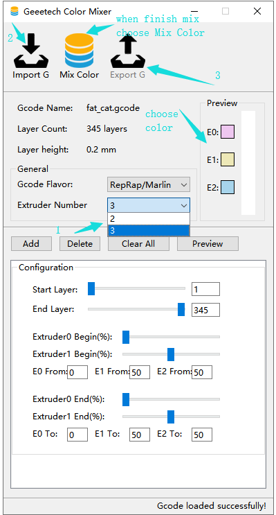

Specific operation method:
wow,enjoy!

Every time I click on "mix color" the programm crashes without errormessage.
tried on twi systems
Win 10 1909 x64
gcode generated with Cury 4.4.0
Re: About the three-color color mixing method of Color Mix
Hi, If so, it may be caused by a gcode error,
When you slice it you need to turn off z hop.
Hi, Extra ups and downs can interfere with the analysis.
