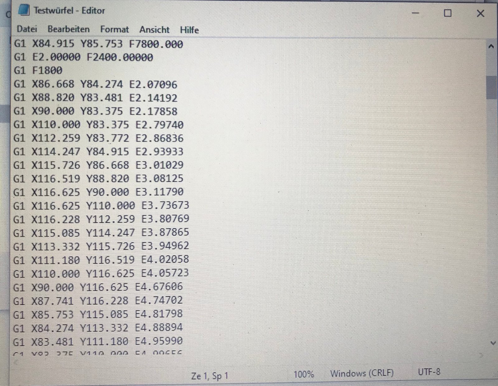

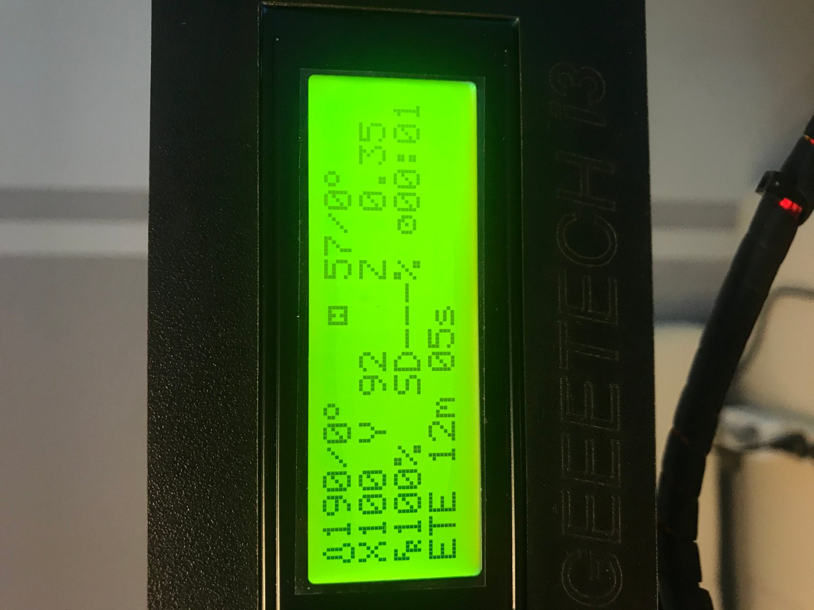

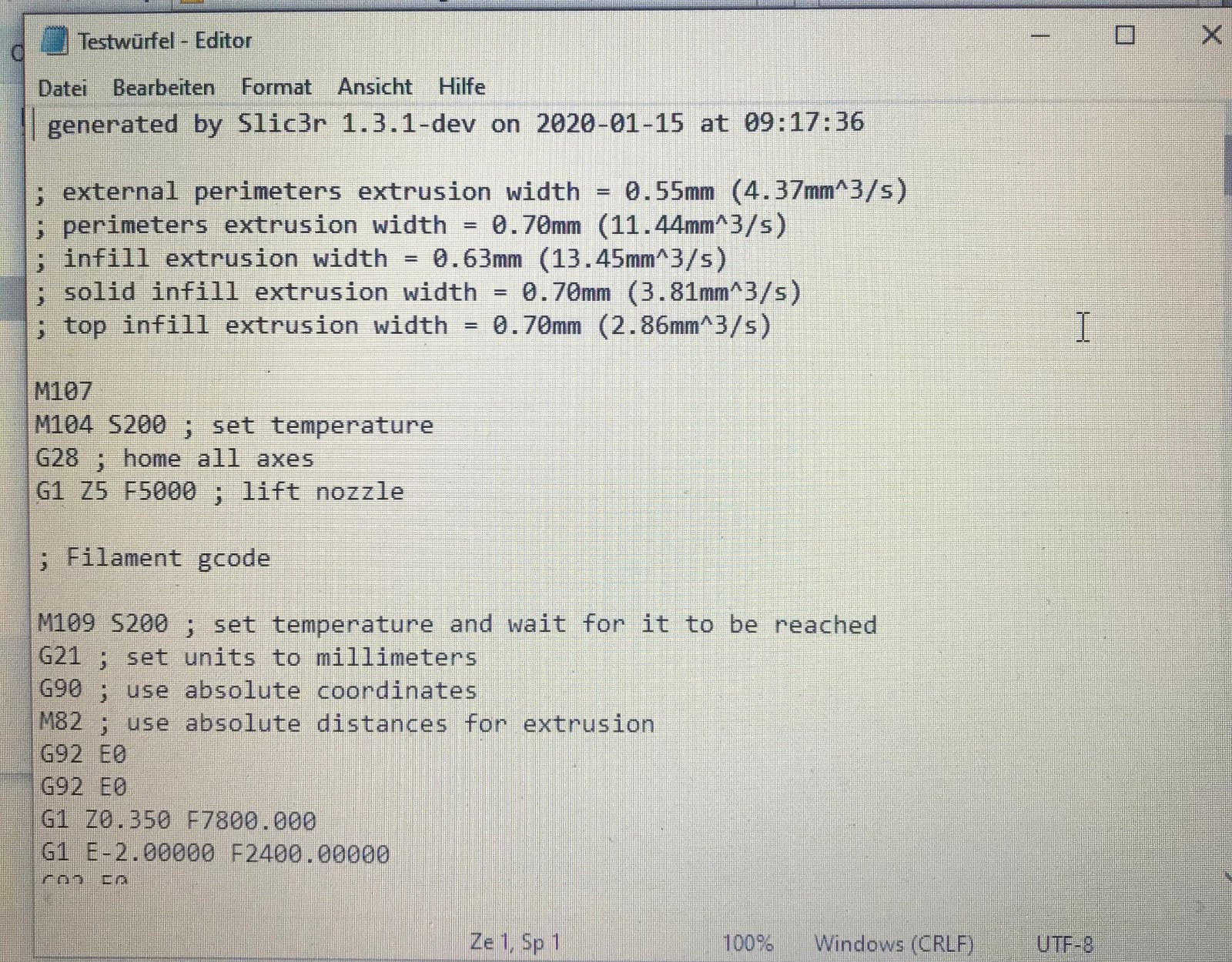

i have downloaded a test cube from thingiverse.i attach a file.
i can't get text data loaded, i have two pictures attached.
which data format can i use for the g code that i can upload it.

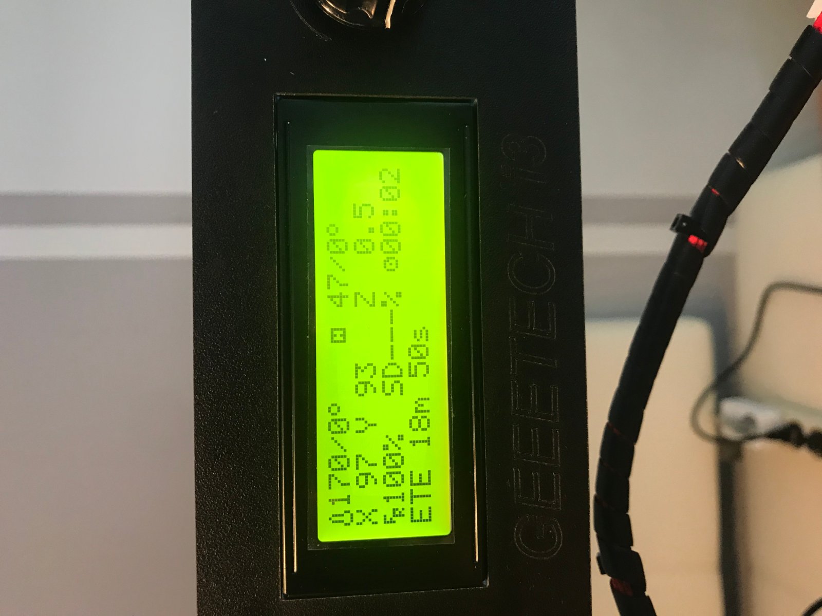

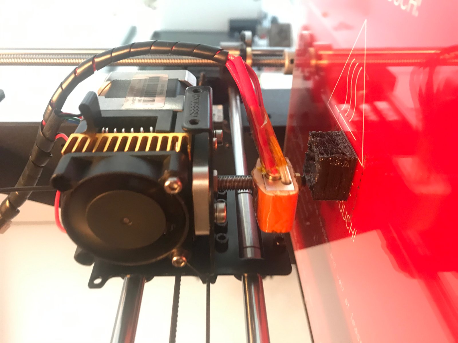

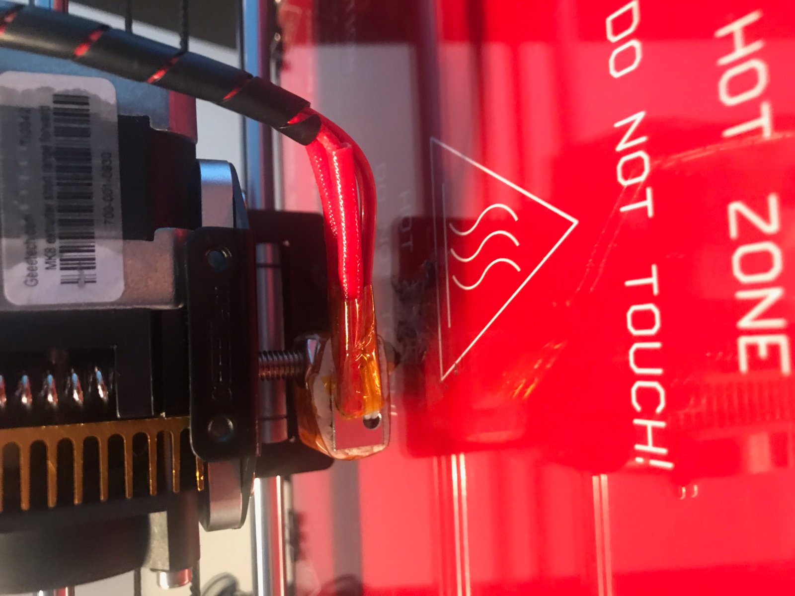

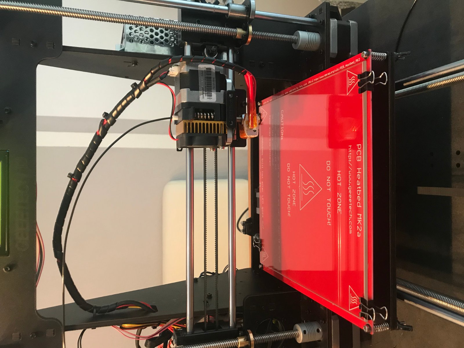

- IMG_5852.jpg (273.18 KiB) Viewed 10181 times
- IMG_5851.jpg (190.34 KiB) Viewed 10181 times

Good William,
I ran a press on the SD card yesterday.

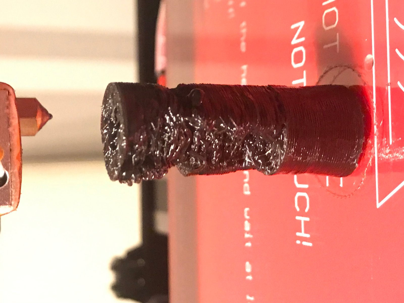

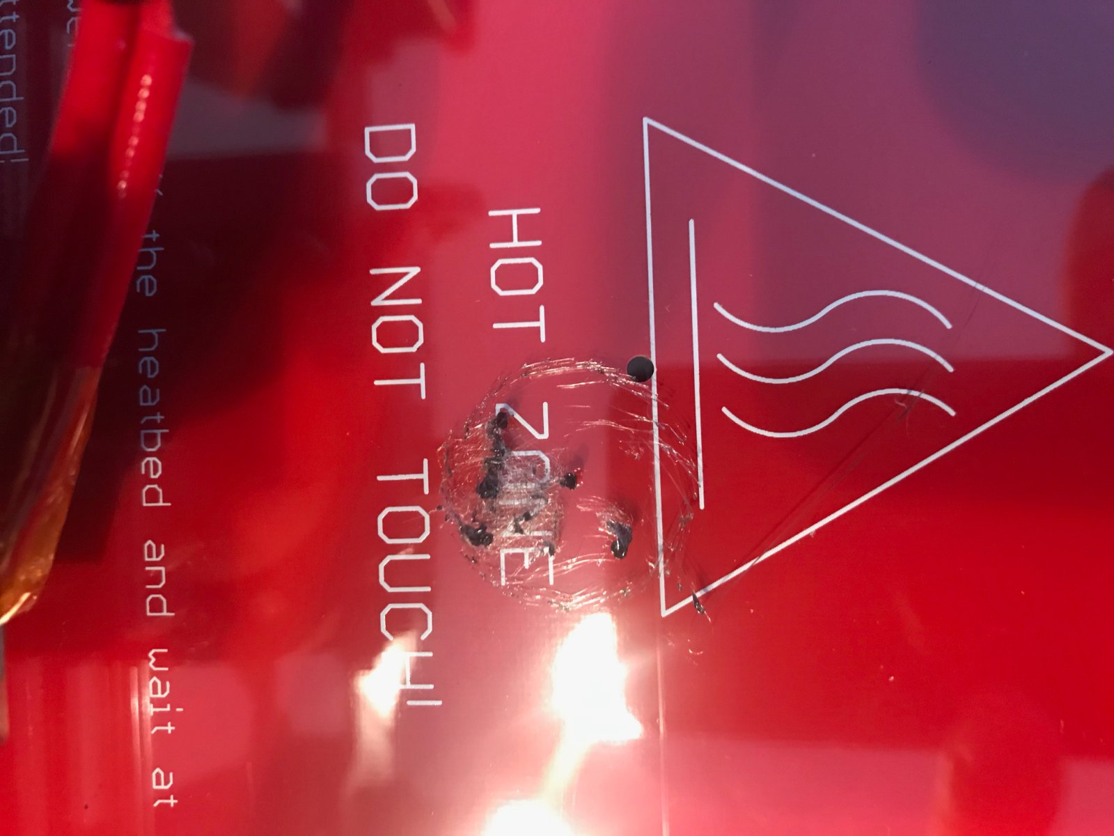

Feed I calibrated the pressure, put it in the home position four or five times and repeatedly pressed Set Home offsets. Then I printed the test you sent me. But there is something wrong with the filament quantity see pictures. Greeting ArndtGood William,

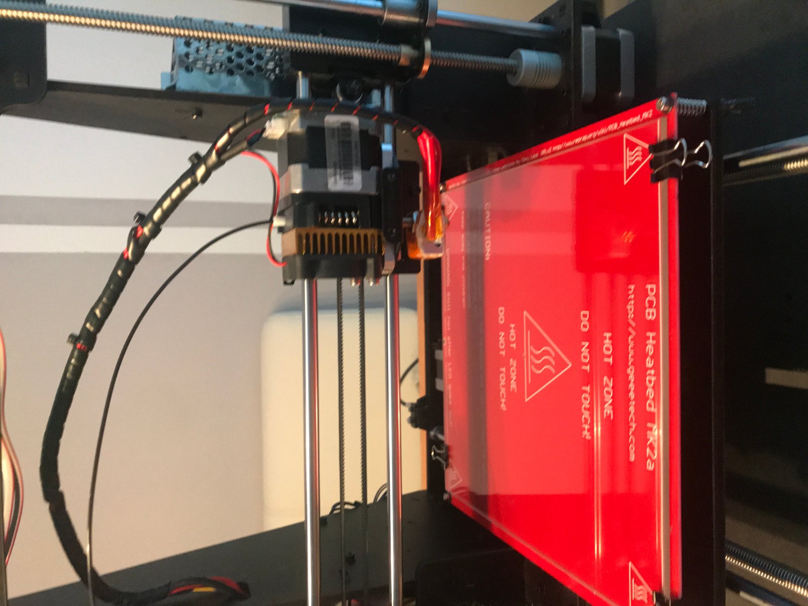

Hello, William,
I have now added pictures.
Sorry for my language i work with a translation program i am not so good in english language
Greetings Arndt
Greetings Arndt

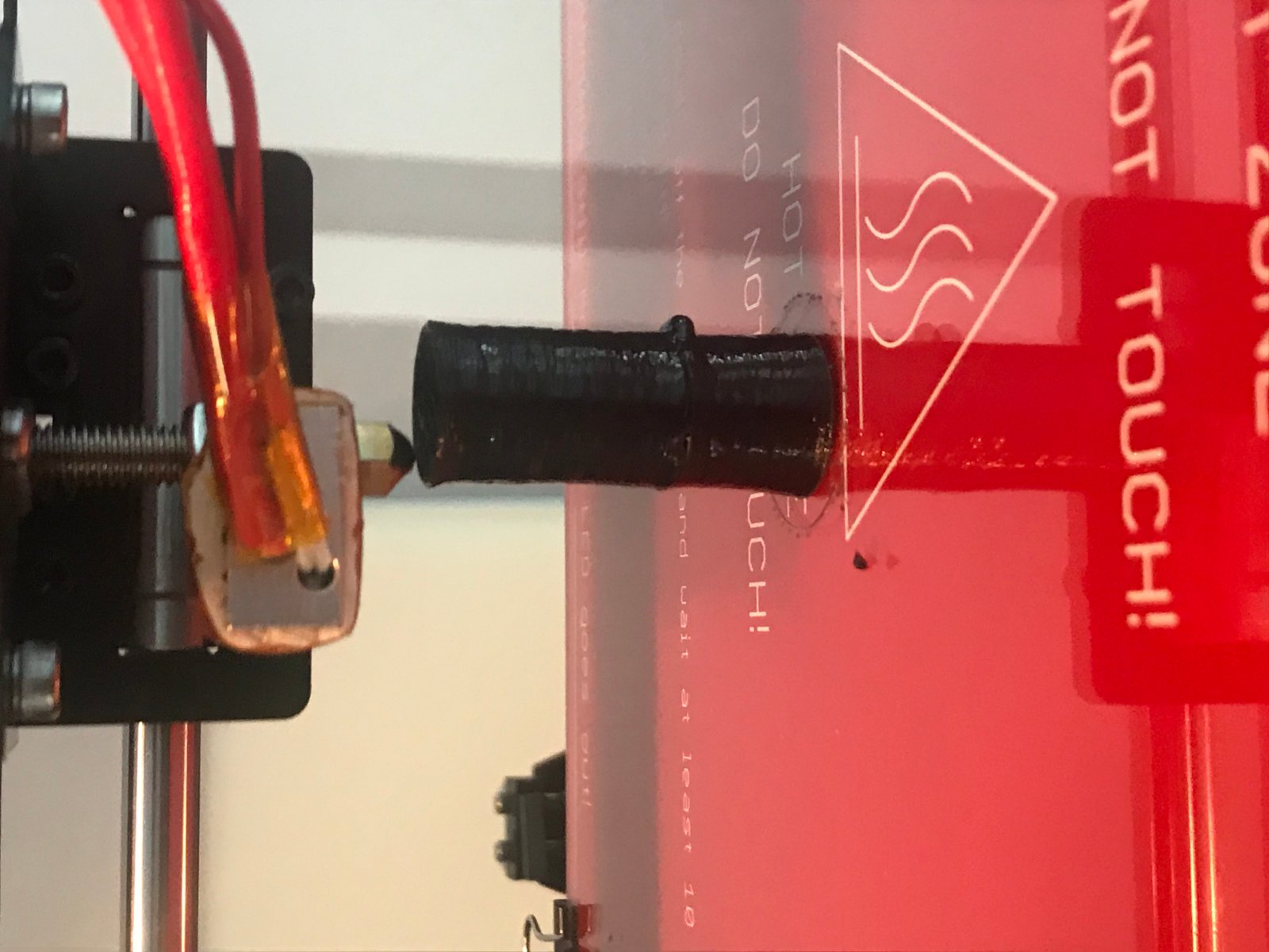

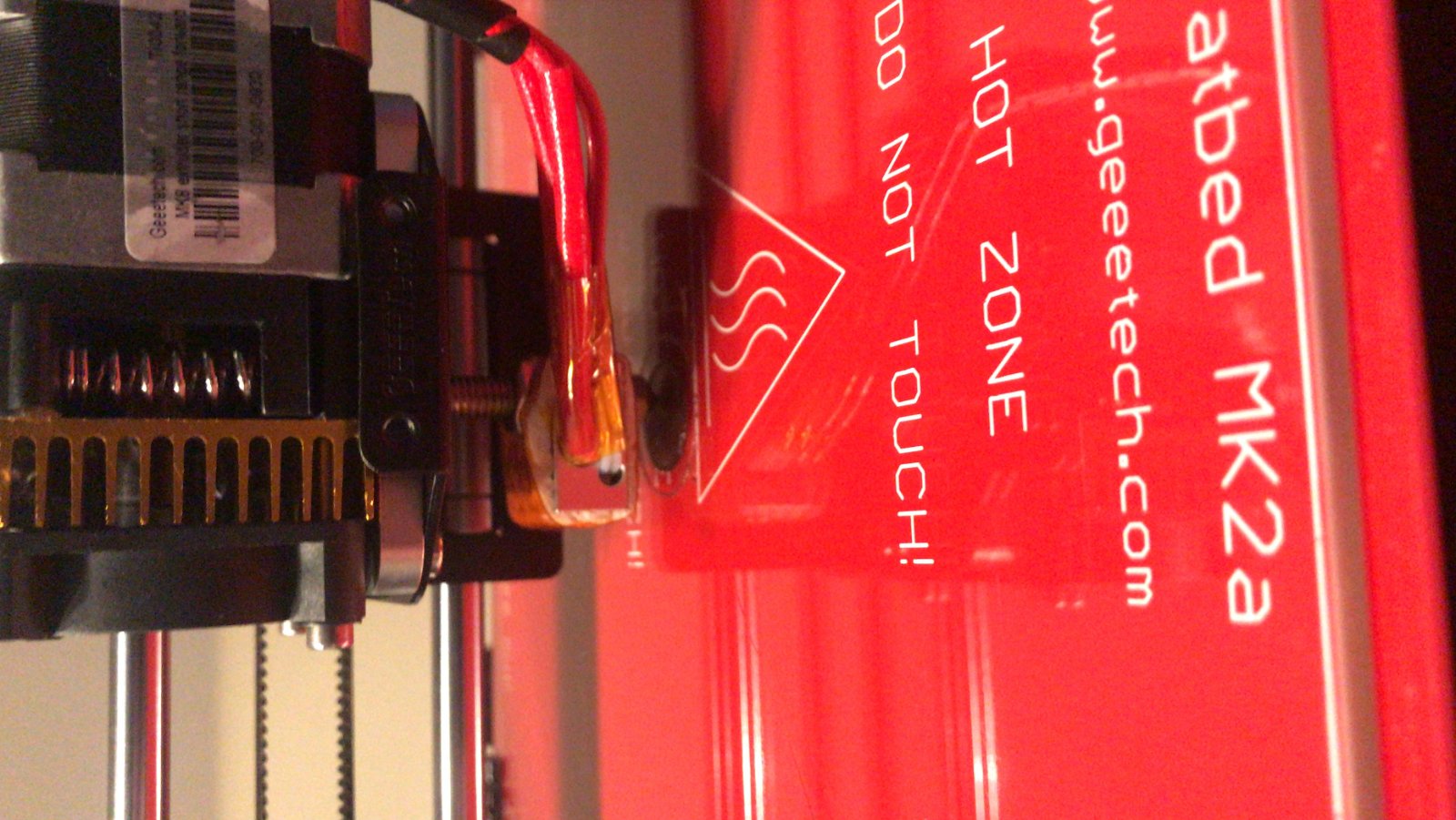

- IMG_5868.jpg (203.69 KiB) Viewed 10142 times
- IMG_5871.jpg (191.89 KiB) Viewed 10142 times

Hi,You need to check your settings for the consumable diameter in the sectioning software,Lukas71 wrote: Thu Jan 16, 2020 4:13 pm Good William,
Feed I calibrated the pressure, put it in the home position four or five times and repeatedly pressed Set Home offsets. Then I printed the test you sent me.bild7.JPGIMG_5863.jpg But there is something wrong with the filament quantity see pictures.IMG_5867.jpgIMG_5865.jpg
Check if your nozzle is partially blocked.
