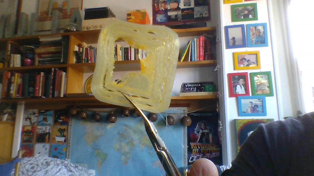

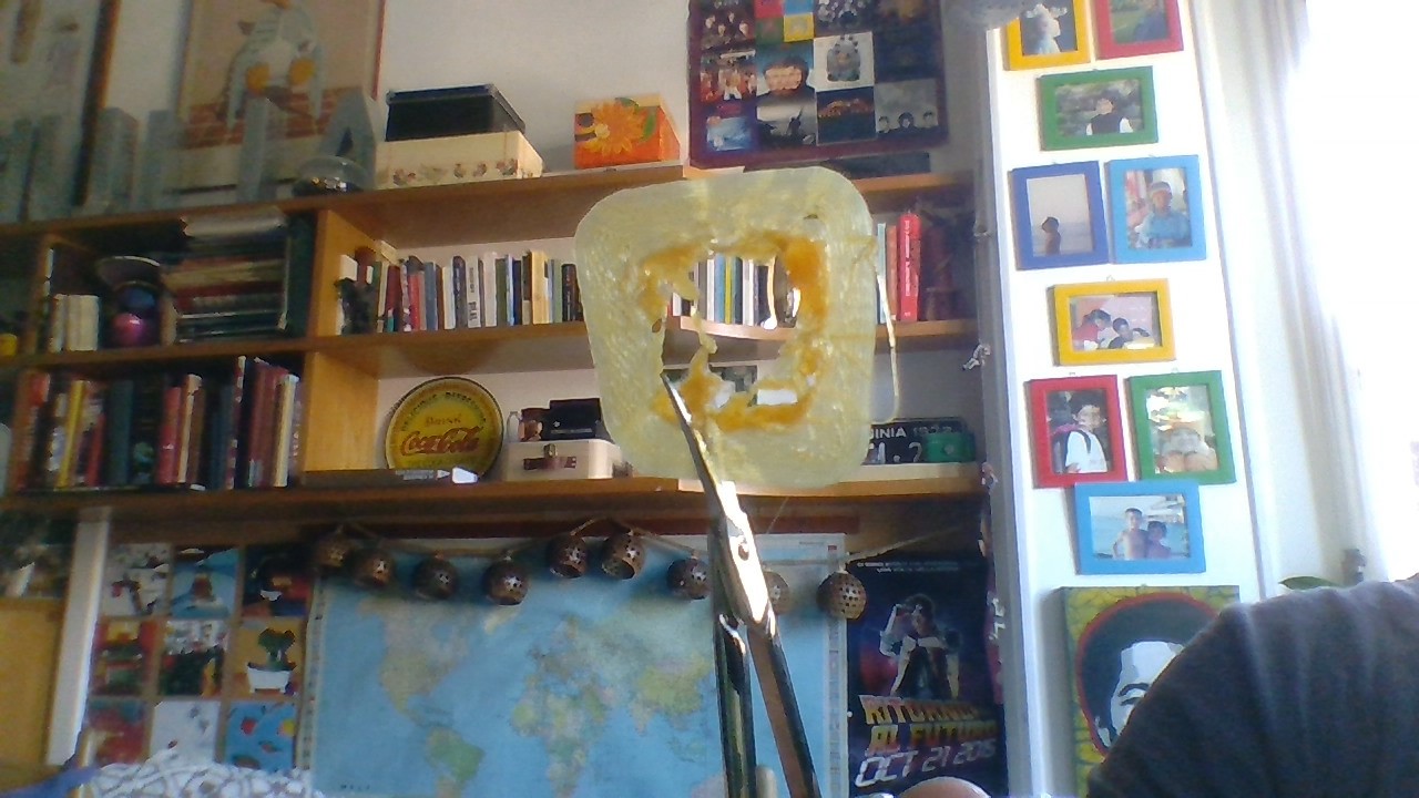

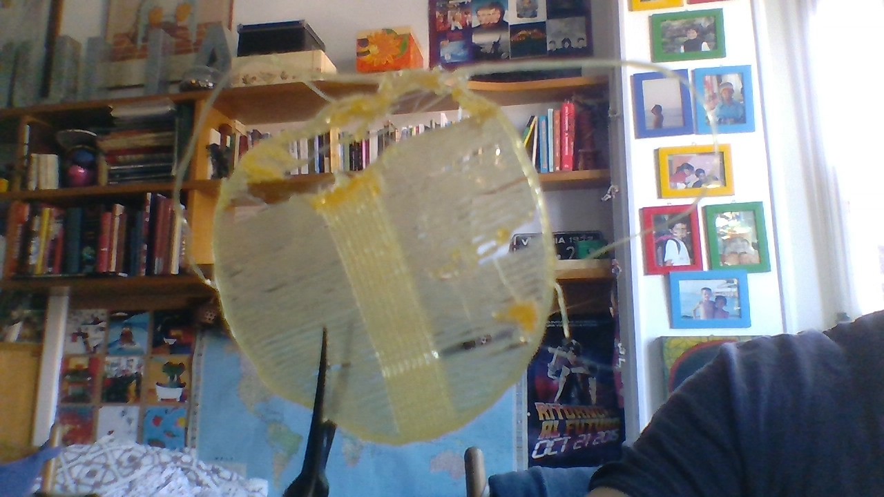

Hi Guys, I bought a new Prusa I3 Pro B but I have a lot of problems. I've done many attempts and i also changed the printer these are mine results (attachments) ( it should be a cube...). I find out that there is surely a problem of subextrusion but i changed the esteps and it seems that now it's ok. I print with Repetier and slice with cura with the params that i found here https://www.geeetech.com/forum/viewtopic.php?t=60980
one of the main problems is that the filament extruded is not "clear" it seems that is over-melted, i think that the pictures describe better what i mean

Hi,what is your printing temperature? You can try lowering the temperature.

i put 200° for the extruder

Hi!
level the bed again, and low to 190º the hotend temperature, and 50º for the bed.
