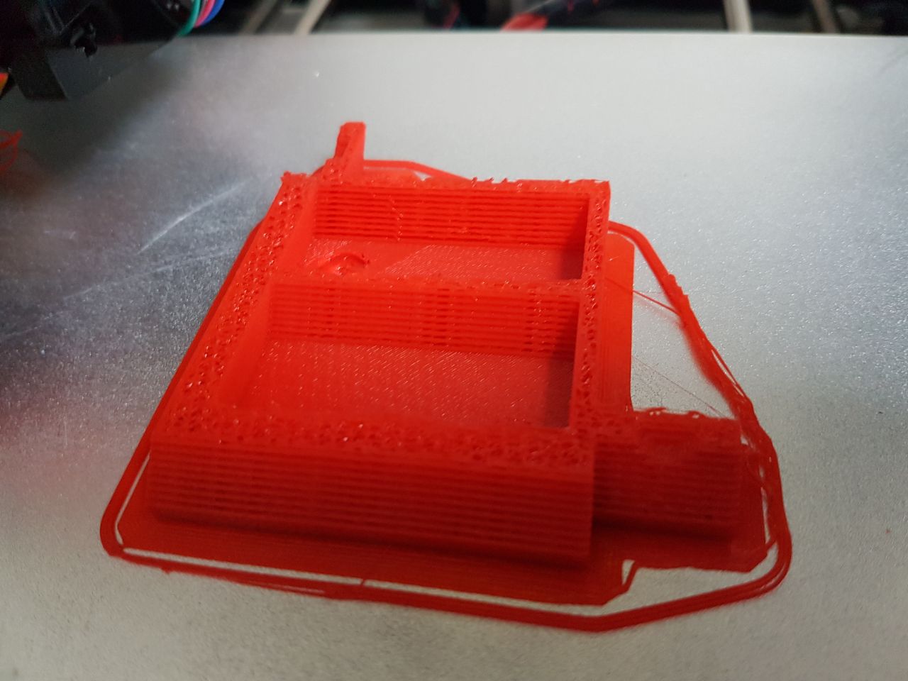

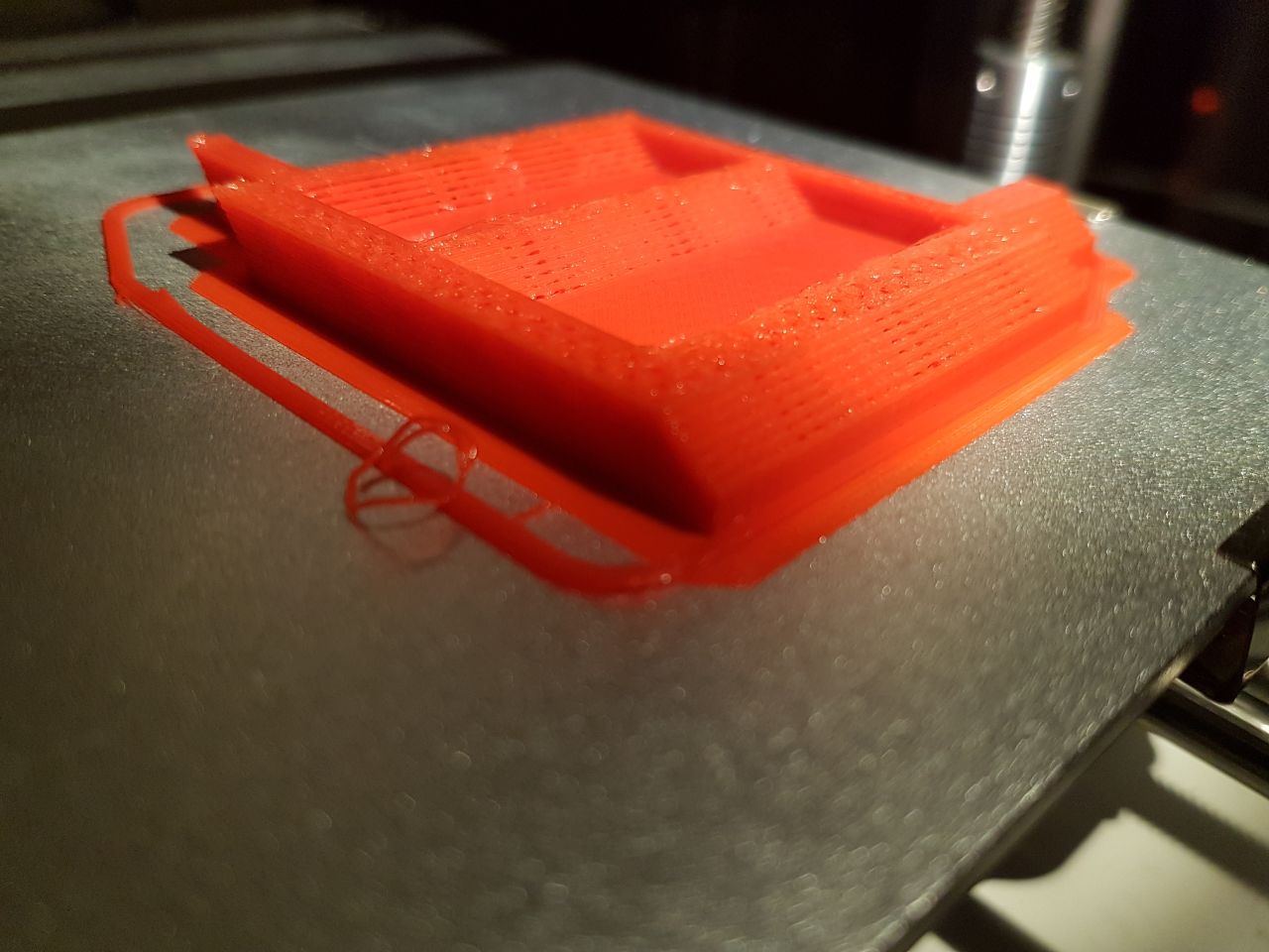

Hi all.
I've a Geeetech i3X (Acrylic) and 'till now I haven't any big issues (1 year of happy printing!).
But, since a while (1 month or so), I'm experiencing a strange Y layer shift.
Attached my last print ...it's supposed to be a cube...
I tried to:
1) tensioned the belt (many tries).
2) changed the motor (I've swapped the Y motor with the X motor).
3) checked the motor current and even changed the motor driver.
The problem still occours...
The strange fact is that it happens sometimes: I've tried different objects in different placing and it seems that there isn't a systematic issue.
The bed seems to move freely on the axis.
Do u have any clues??
Thanks!
E

check the cable going from the controller board to the stepper motor. Since there is no feedback mechanism from the motor to the controller, if the controller tells the motor to move and it doesn't you could see artifacts like this. The Z motors are the only motors that shouldn't have wear issues with the cabling but all the other motors have their cabling moving and over time they could fail. My extruder cable failed after about a month of use. Good luck.

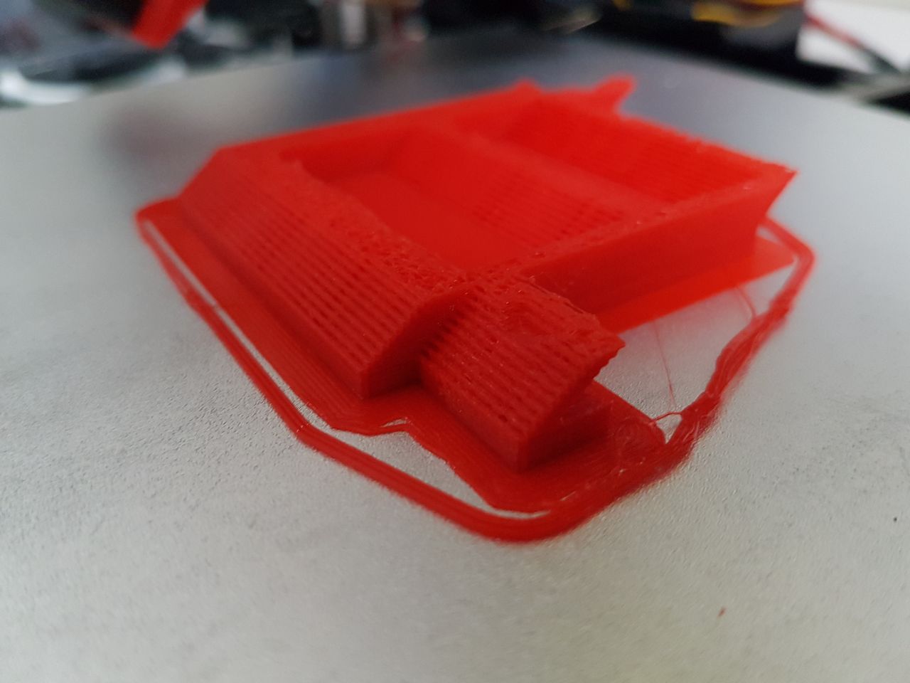

Re: Y layer shift
unfortunately I had the same problem.
I've switched the Y cable with one of the Z axis and the result is the same.
Now I've rotate 90° left the piece, I'd like to see if the shift will occour on the X axis...
Then I'll try switching the cable with the other one of the Z axis.
