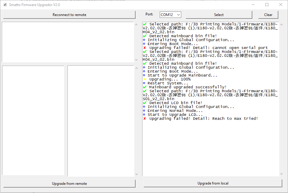

I finally figured out that there is an SD card behind the actual LCD screen. I removed it, reformatted to FAT32, copied the following files to it:
E180_S01_V2_02.bin
config.txt
and also the entire system folder that was located in the UI folder.
While the (LCD) SD card was out of the printer, I uploaded the E180_M04_V2_02.bin file using the toolkit v2.0. It said it was successful and it restarted. I turned the printer off, put the SD card back in, powered it back up, loaded the E180_S01_V2_02.bin file with the toolkit v2.0 and then i get an the following error: Upgrading failed! Detail: Reach to max tried!
I am at my wits in! I sure wish someone could help me!![Image]()
