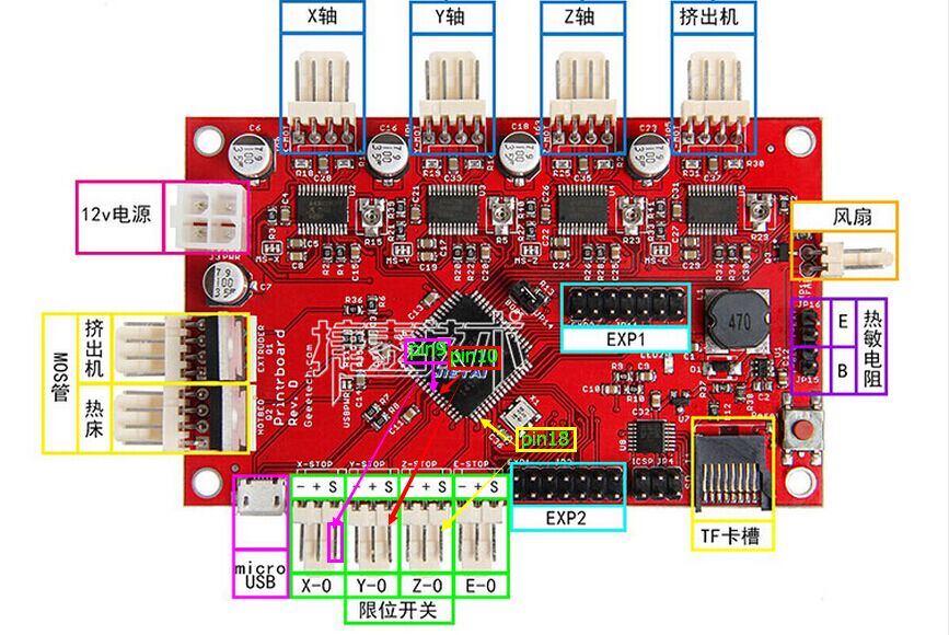

Dear friend,
1.Please make sure the firmware is not revised.I have sent it to your email box,you can check it again.
2.Did you always press the button "HOME"?You can try to disconnect and reconnect it again.
3.Please check the endstop is well connnected with the board.
4.Please check the chip is normally connect with "S".(See the added picture)
After you have tried,please tell us the results.
Hope it could be solved soon.
Best regards
Best regards
