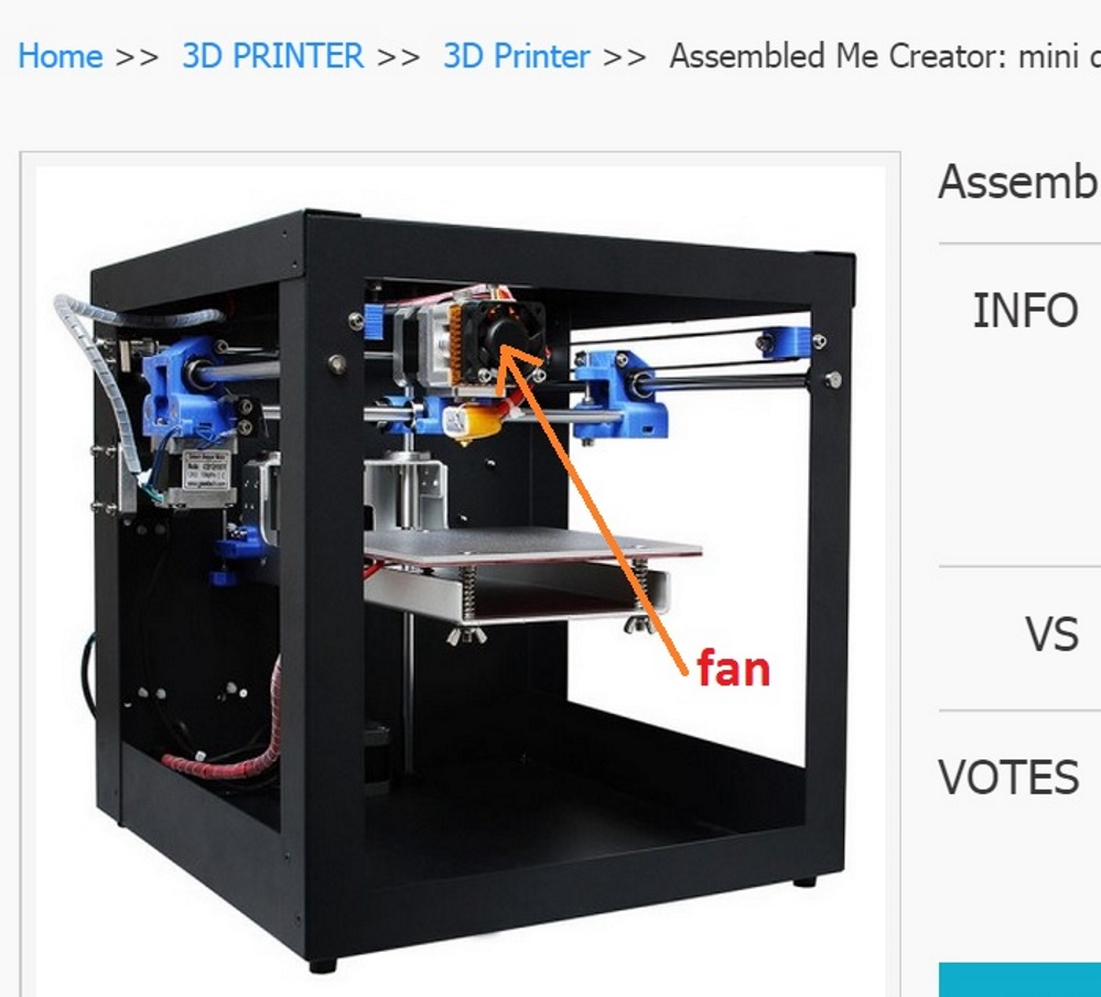

Hi John, I've just visited the geeetech website, and found that it actually should have a fan attached tot he extruder (see image).
The 2 units MeCreator that I received did not come with the fan.
The fan may be the solution for the filament not melting at the upper part of the barrel of the extruder, what do you think?

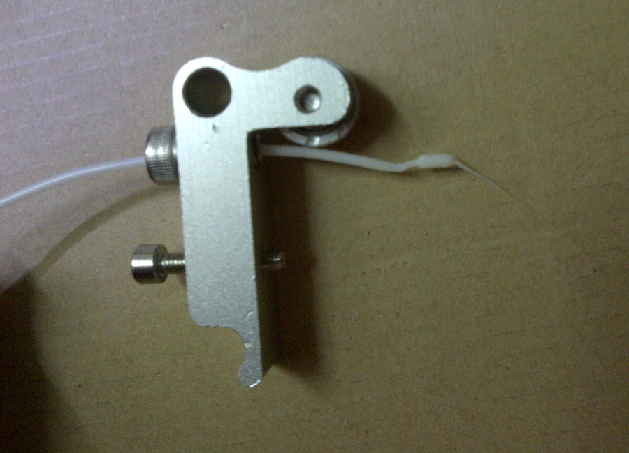

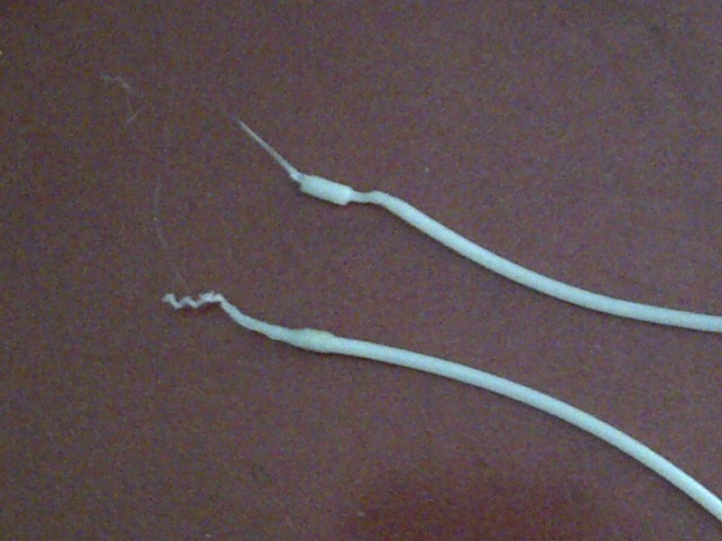

HI John, is your extruder has a fan blowing to it? my units do not have such fan.
Re: Me Creator cannot move to X+, Y+, Z+
Hi John, I tested the gcode you sent to me 'Test_40x30x10_PLA_1.75_0.3.zip', the result is the same, the filament jam after first layer. I have a video on it, how to send to you. Meanwhile, please see the images for filament I pulled out after it jam the extruder.
Please give me good advice to end this frustration. I received 2 MeCreator last October, but it is still not able to do any print.
Is the engineers at Ge Tech have given up on this product? no one seems to take any initiative try to solve the problem, the sale person at Ge Tech is incommunicado.
