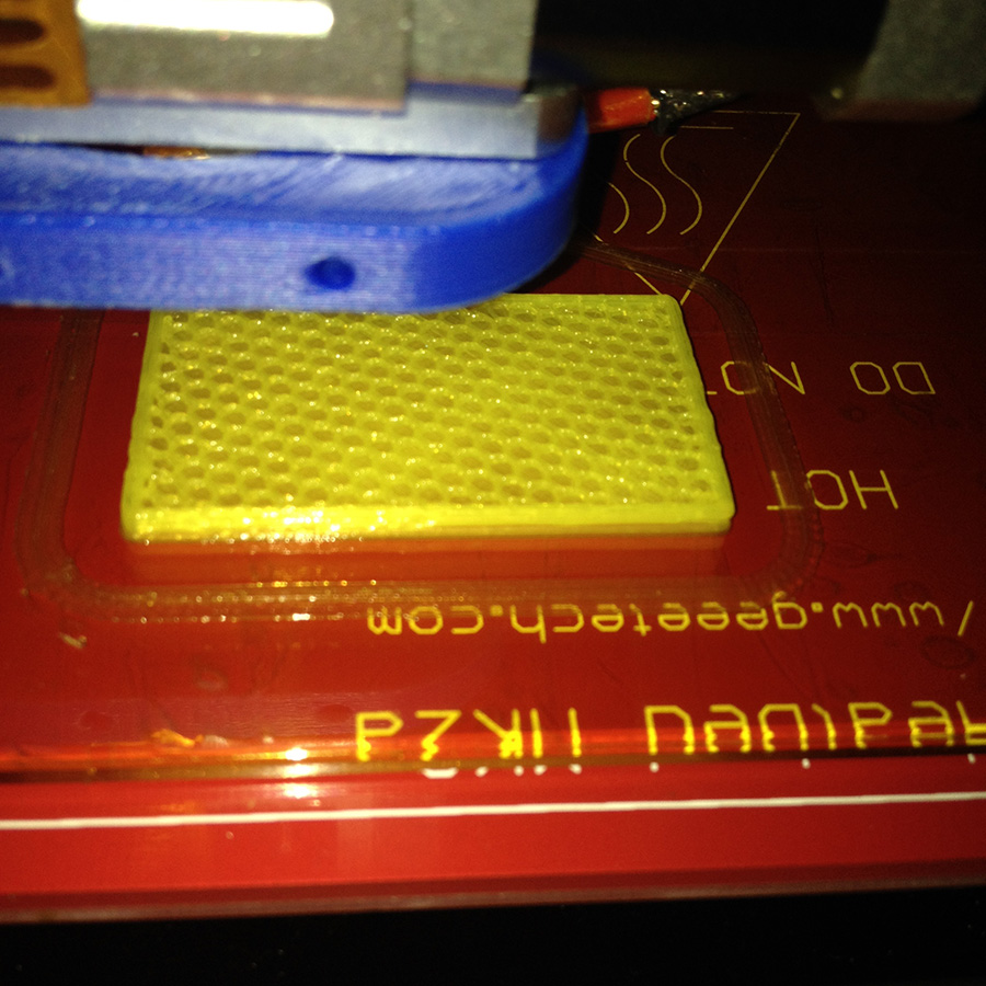

if i try to run at 200 it will not extrude at all. As is show in the picture i am attaching shows i get excellent prints till between 20 - 35 layers and then the extruder seems to block and the flow stops and I get stringy melted plastic instead of nice orderly prints.
