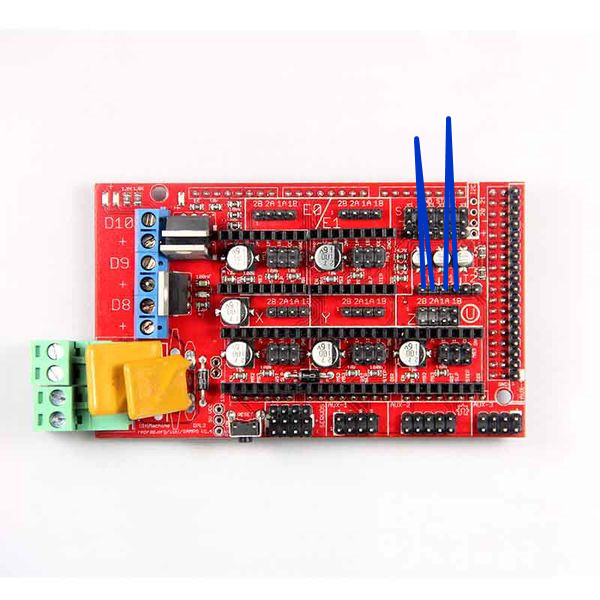

zhangxueyou
Posts: 1405
Re: mintemp error
Post by zhangxueyou »
Please plug the wire of themistor, then use a wire to make the 2 pin short out, as shown in the picture.
If the value is as same as before. We can conclude that something wrong with thermistor.
ii3edus
Posts: 18
Joined: Sun Mar 15, 2015 11:50 pm
Re: mintemp error
Post by ii3edus »
i did that and it still say 0. so does that mean i have 2 bad thermistors cause the bed say the same as the hotend. but if i manually set the temps (230 hotend 115 bed) the printer heats up and the display shows the set temps and the actual temp climbing.
