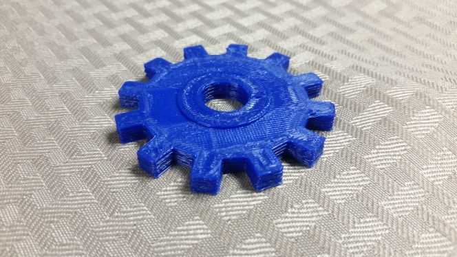

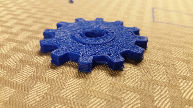

Here are some more setting I changed. I slowed down my perimeter print speed, increased my perimeter wall to 4 (number of external layers or shells), and increased my extrusion multiplier to 3. I have learned 3D printing is a trial and error thing. You may need to play with those until you get what you want. I am happy with the results I am getting now.
FYI: I am using Matter Control for my 3D printer software. The other one has the same settings, but the names may be a little different.
Before
Before
After
After
Now
Now

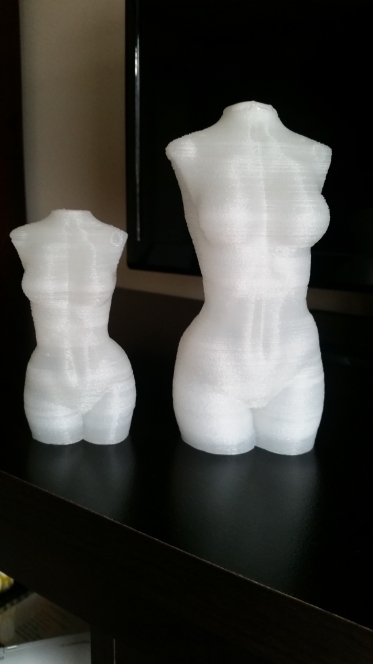

After I Tighten the Y axis belt , I look better ^_^
only some surface have hole or big spot .
FullSizeRender (62).jpg (100.81 KiB) Viewed 14318 times
FullSizeRender (63).jpg (95.23 KiB) Viewed 14318 times
FullSizeRender (64).jpg (139.76 KiB) Viewed 14318 times

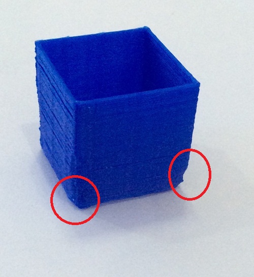

Now I test basic cube like photo
FullSizeRender (65).jpg (73.45 KiB) Viewed 14302 times
Link : Video
https://drive.google.com/file/d/0B7Vu0J ... sp=sharing
I see only problem in red circle ,other surface is good
I look like when hot end feed in that corner , it is not smooth , trip
Thank
