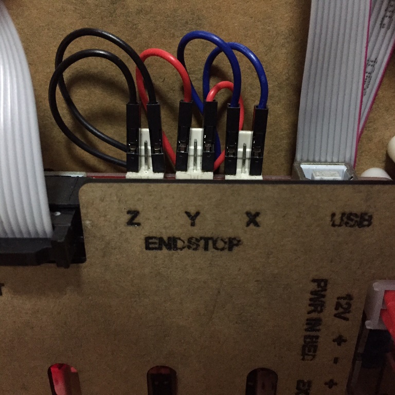

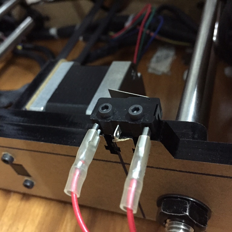

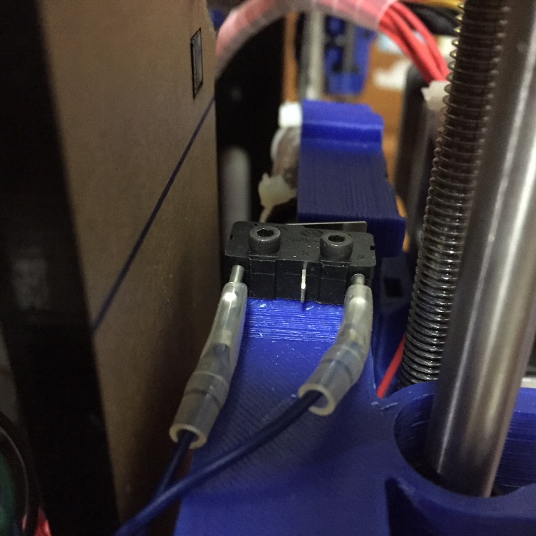

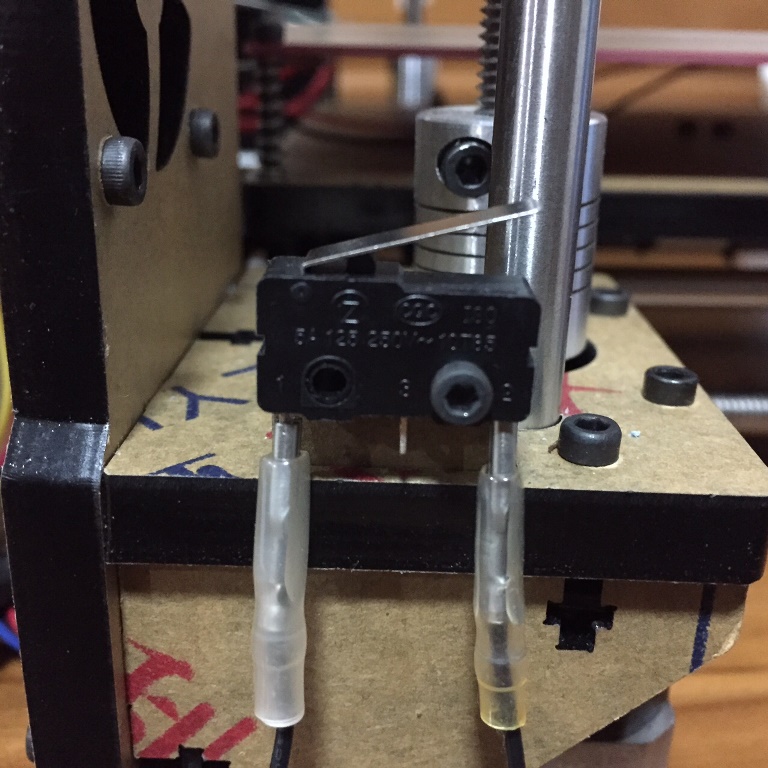

2. I checked the connect of endstop of x , y and z ,there are correct as the following attached pictures, but the problem still remain.

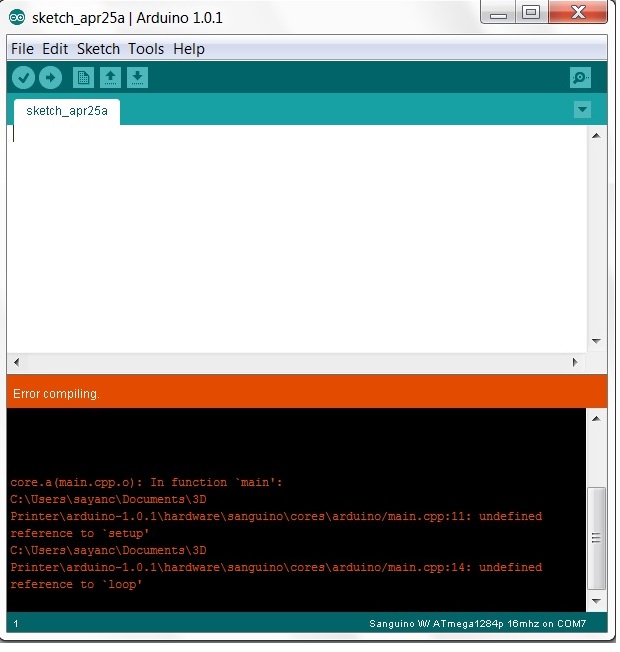

I try to do follow this page http://www.geeetech.com/forum/viewtopic ... 20&t=16253 but there is the error as the attched picture. I do not know what can I do next?

I can not see any file in Arduino1.0.1. You should drag all the files of firmware into Arduino.
Re: Problem in Min Temperature and Stepping Motor
Ok I understand now. Now issue 2 and 3 are correctly solved.
