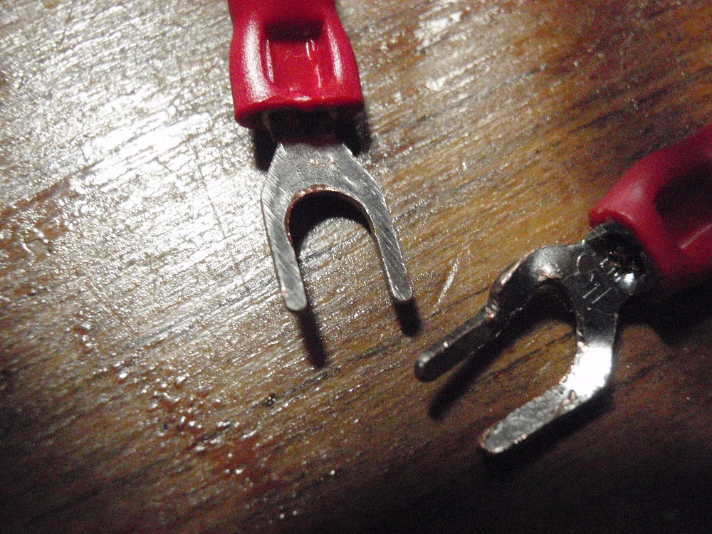

Something else you should look at
The connections that go from the power supply to the board do not exactly match, one of them I had to adjust to fit under the screw.
Here is a picture of what it looks like after I adjusted it to fit.
What do you think? Could these be causing a problem?
It is difficult to notice in the picture but one was wider and thus could not fit. Check the stock that you have you might have one just like what I describe.. :P

The connetor on power cable is thicker than the older one, so it should be firmed under both screws and metal spacer. But it does fit the power supply exactly.

The problem exists in the power supply.
