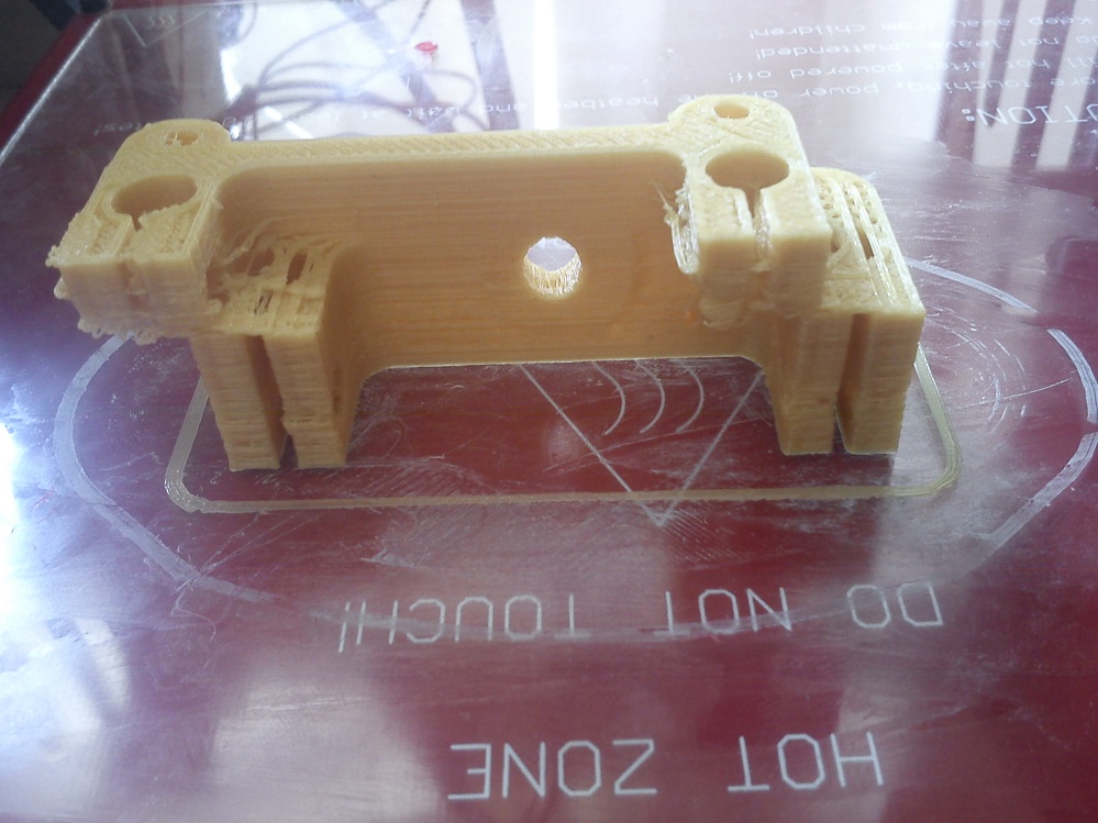

This is my last print. it is possible that the filament stacks always and doing this all time ? I'm planning to change the sanguino board with an arduino mega and ramps 1.4. The firmware is the same and the only thing that i change is the type of board ?

Re: Printer stops randomly
The x axis jumped.
Is it hard to move x axis with you hand? If it's hard to move it, the x belt is too tight, please loosen it properly.
If not, you can rotate the screw on x motor driver to raise the voltage between the screw and GND to 1V.
If possible, please mind what happens when x jumps.
Finally solved, I did exactly what you said, half rotation of stepper driver potentiometer counterclockwise and i got excellent prints
