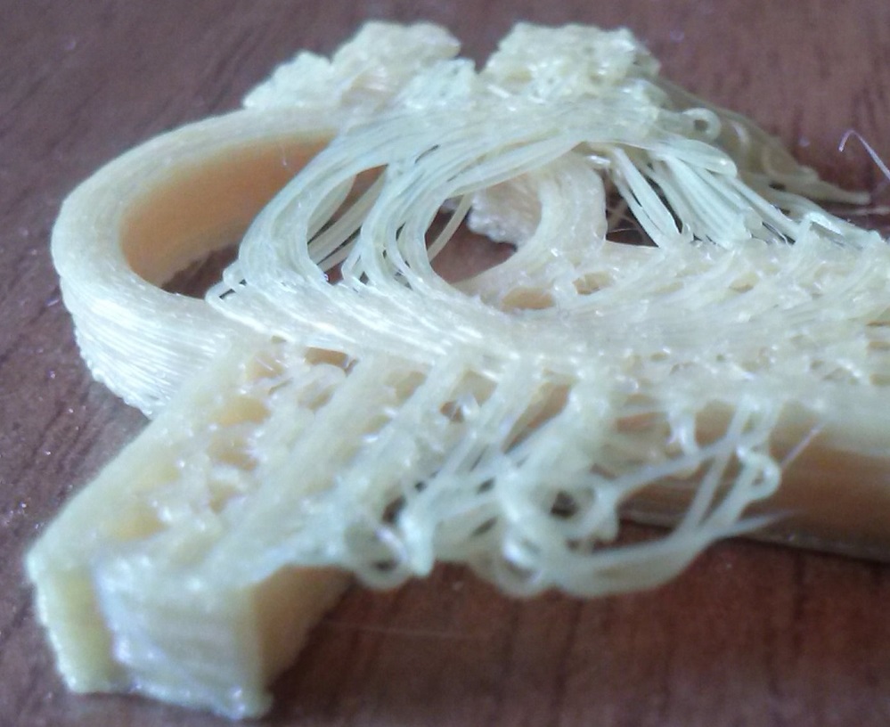

Now i'm having a strange printing issue, the print starts fine and while is been in progress, the printer seems to lose coordinates.
Slicer is causing this ?
Please check the attachment and give me a possible solution.
Thanks
I solved the problem by changing the connectivity from usb 2 to usb 3.
Thanks

Slicer is one of the factors, you can refer to this page to set it:
http://www.geeetech.com/forum/viewtopic ... 24&t=16366
I think there is another reason can cause bad printing. Somewhere of the filament must be stuck when printing (I don't mean the nozzle is jammed), so the extruder motor has not enough power(even it reaches maximum power) to pull the filament. Please make sure the filament can be pulled by extruder smoothly.

Maybe it is microstep issue.
If your stepper driver is A4988, please make sure all the jumper caps(12 in all) have been well plugged under each A4988.
If your stepper driver is DRV8825, you need to plug only jumper cap to the pins beside "MS3".
