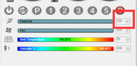

Re: motors extruder not working
do you set up feet rate?Normally,the feed rate is 100.
- QQ图片20150731090248.png (20.95 KiB) Viewed 11147 times
yes my feet rateis 100
