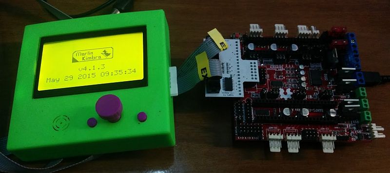

Re: Ramps-FD v1a
I have a card-FD Ramps v1a with ArduinoDUE
Printer type Cartesian type Prusa I3
FW Used Marlin4Due portring Kimba http://marlinkimbra.it/
I also tried RepiterFirmware
but I prefer to Marlin
I include photos of my current installation
Thank you
Thank you
- RampsFDv1a_Marlin.jpg (44.21 KiB) Viewed 11553 times
