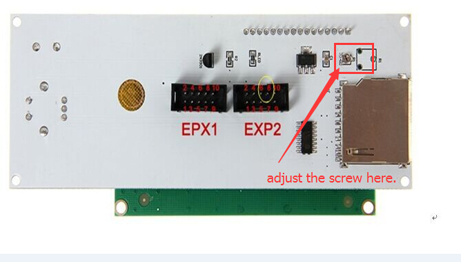

Hello all,
When I uploaded the code to my G2S all that appeared on my LCD screen was the backlight. No rectangles, no display, nothing, just the light. Any suggestions?

You can adjust the screw of the LCD controller to see if it works.
Or you have plugged the LCD wire to the SD outlet, try to swap them .

Mark wrote:You can adjust the screw of the LCD controller to see if it works.
Thank you very much, that fixed the problem
