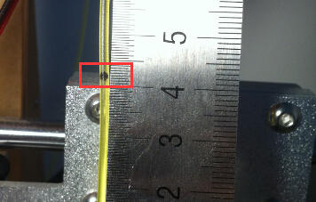

The extrude speed wherher too fast or too slow will affect the quality of the object.
You can make a mark on the filament,and manual extrude 10mm , then measure the actual extrude length, compare this two length to reduce or increase your extrude speed.
And 0.2mm is perfect resolution for your printer .

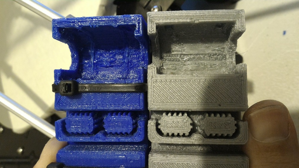

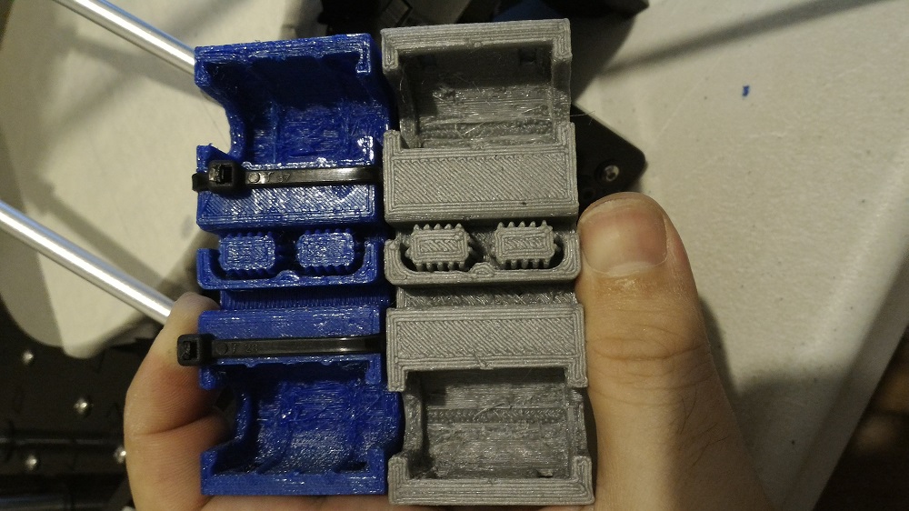

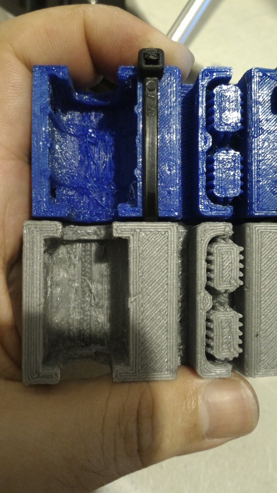

Hello, problem still persist this is after i've checked the motor settings .This is my second attemtp to print these carriages but seems like geeetech provides slightly bigger stl so it won't fit...
