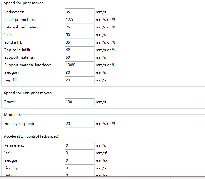

He's not playing around. How about slow your speed? I'll attach my speed for you of my I3 X. maybe it can help you.

That looks great I will try that later today and give you feedback. And thanks for the effort. I hope it works.
