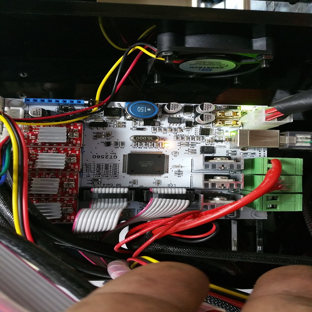

computer board
no red leds?
no red leds?

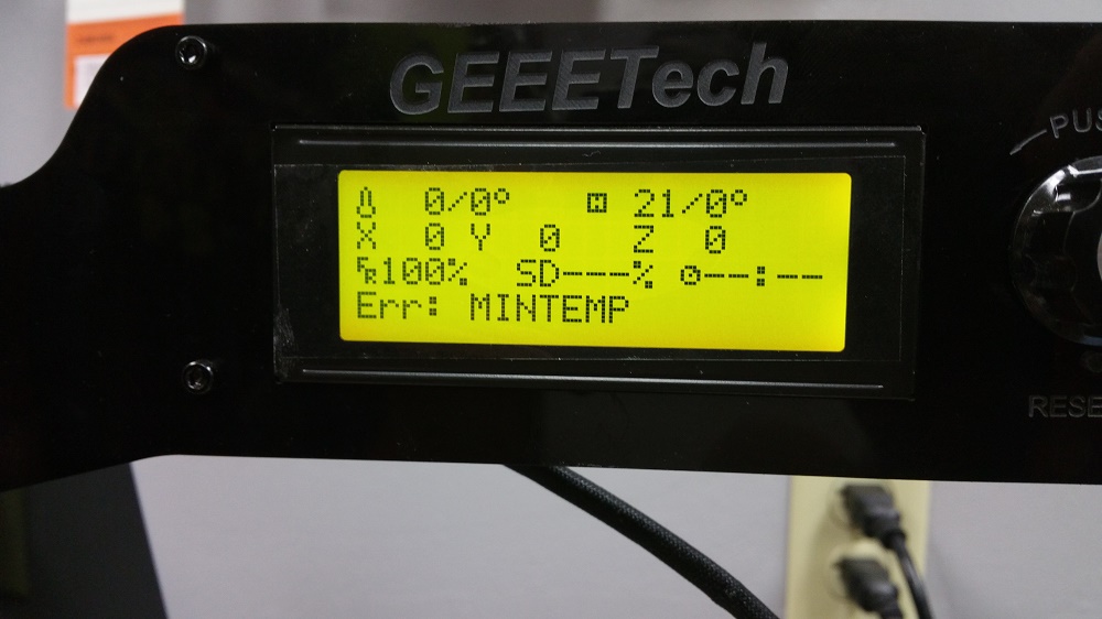

i dont see any red leds lighting up and i have 3.3 ohms across the heating cables. before i was able to manually heat the hotbed up but not the extruder. now neither will do anything.
lcd reading error mintemp
computer board
computer board

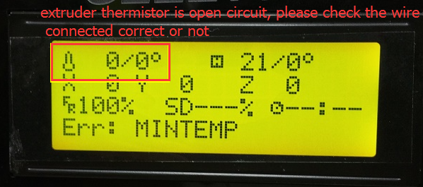

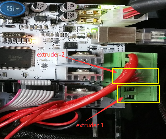

hi, there's two places to check:
1) you have connected the extruder heating wire to the wrong place, it should be the first one;
2) the thermistor of the extruder1 is open circuit, please check the wires, see if not correct connected
