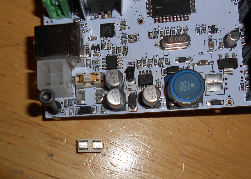

kazmut wrote:hi, I think this is blown thats why I can't get power from the power supply. What do you call this fuse? Can I get it somewhere else?
it's model is 0451010.MRL1808-10A125V.you can buy it in usa.

I have a new issue. I was rerouting wires of the extruder to the PCB and bumpped one of the fuses when the plug from the extruder. When I looked down, one of the fuse holders fell off the PCB. It must of not been soldered all that well. Lookung at the the PCB, I see a bit of an outline of solder where the fuse was and solder resin, but the the fuse holder looks like is was never soldered. The extruder plug had got weadged between the cap and fuse holder and when I pulled it back, the the fues holder fell off. Should this of happened? I have had so many issues with my printer and this one now top it off. I do not think I can get in there with a soldering iron to put it back. What should I do?

Guys i had the same problem with the fuse. Somehow the connection of the power supply wasn't propperly connected, and when i turned the printer ON, i saw a spark from the power supply plug on the board....and now the power is making a sparkling sound, and the printer doesn't turn ON, only wuth the USB. Hope nothing else is broken....the problem is that i'm from ARGENTINA, and those kind of fuses are really difficult to import.

Post by Mark »
your fuse might be dead, you need to contact the seller to replace it....maybe the PSU too.
