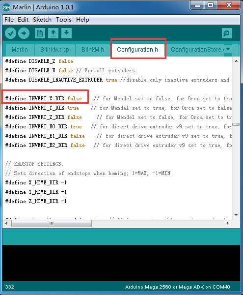

Which direction should each drive move during the Auto Home command? My Y drive moves the bed aft towards the Y limit switch, the X drive moves the extruter left, away from the X axis limit switch, and the Z drive moves the extruter down towards the bed.

all of axis should go toward their endstops.it seems that your x axis direction are reversed.you can change it's direction in the firmware.
