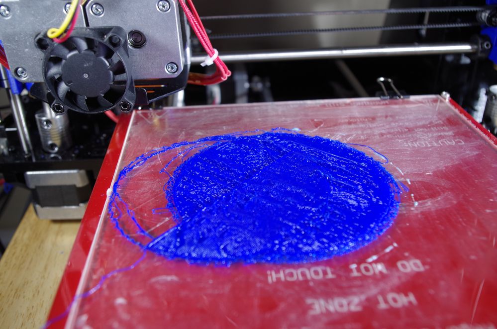

I'll see if I can upload a file here. I just got the file size reduced to uploaded here. I was attempting to printout a coaster, which is used under drinking cups. You can see the wild arcs that it is making.
I also have a short video of the printer working on this print.
Link is: https://drive.google.com/file/d/0BwX7dD ... wzTk0/view
One thing that you will notice in the video is that it is bumping against the layer that it just laid.
I stopped the printer just after taking this photo since the printer was starting to run the print off of the base.

how's your nozzle distance between the bed after homging? I think it is either a litte far or too close to the bed, so the nozzle will collision to the bad layers it just laid.
And the temperature you use for the PLA? the slic3r settings? Proper settings for slic3r will be great help too.

While I have never been able to get a good print from this printer, it has gotten much better then the sample print here. I strongly suspect that something in my settings or in my adjustments were the problem. I found with time that I had the temperature turned off for all layers above the 1st layer. As I said, figuring out what all of the settings do is new to me. And I don't have a background in any sort of electronics.
