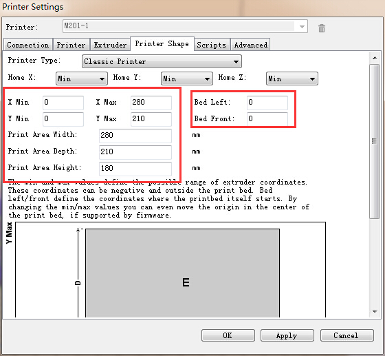

now my prints come out real small??---have you changed the steps to those that in your original firmware?
And the bed center, you can try to calibrate it here:
